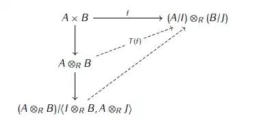

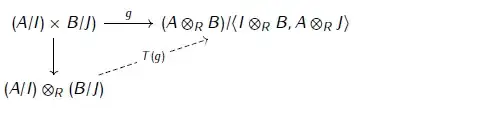

Define the map $g\colon (A/I)\times (B/J)\longrightarrow (A\otimes_R B)/\langle I\otimes_R B, A\otimes_R J\rangle$ by $g(a+I,b+J)=a\otimes_R b+\langle I\otimes_R B, A\otimes_R J\rangle$.
Of course $g$ is well-defined and $R$-bilinear, therefore we have, by universal proprerty of the tensor product, an induced homomorphism $T(g)$.
(Notice that $(A\times B)/(I\times J)\approx (A/I)\times (B/J)$). We claim that $g$ is the wanted isomorphism. As done above, we define an inverse of $g$. To do this it's enough to use the universal proprerty of the tensor product and that of the quotient.
Here $f\colon A\times B\longrightarrow (A/I)\otimes_R (B/J)$ is defined by $f(a,b):= (a+I)\otimes_R(b+J)$.
