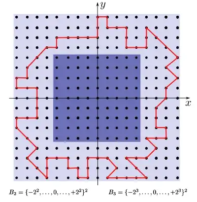

Consider a grid $G$ in the $\mathbb{R}^2$ plane formed by the points $(x,y)$ with integer coordinates i.e. $G=\{(x,y)\in\mathbb{R}^2: x\in\mathbb{Z},\;y\in\mathbb{Z} \}$. For $n>0$ let $B_n$ square centered at $(0,0)$ whose sides have length $2^{n+1} + 1$. Note that $B_n=\{-2^n,\ldots,0,\ldots,+2^n \}\times \{-2^n,\ldots,0,\ldots,+2^n \}$.
Consider all the circuits as a finite set of points $p_{0},p_1,\ldots, p_{k-1},p_k,p_{k+1}\ldots, p_n$ such that:
  • the starting point $p_0$ is equal to its endpoint $p_n$, that is, $p_0=p_n $;
  • the circuit trace has no self-intersection;
  • $p_k$ and $p_{k+1}$ are neighbors for $k=0,1,3,\ldots,n $. By neighboring points we understand the points that are distance 1 according to the metric $d(p,q)=\max\{|x_p-x_q|,|y_p-y_q| \}$ for points $p=(x_p,y_p)$ and $q=(x_q,y_q)$ in $\mathbb{Z}^2$.
For an illustration with rectangles $B_2$ and $B_3$ see the figure below.
.........................Circuit round the ball of radius 2 in Z ^ 2
Question. What is the maximum number of circuits that can be drawn within the square $B_{n+1}$ and out of $B_n$ square?
My attempt was to divide the region where the circuit can pass in 8 rectangles. As shown below. And then try to count the number of paths running from side to side of each rectangle.
.........................!enter image description here

    don't forget the circuit path need not move regularly from one of your twelve rectangles to the next. even in the simple case shown, with $B_3$ and $B_2$ some retracing is possible. do you have the answer for the total number of circuits in a $B_n$ (i.e. without a "forbidden" inner zone)? – David Holden Apr 02 '15 at 15:15
  • @DavidHolden +1 Yes. That's why we could not solve the problem with this strategy. But at least I can get a lower bound for the number of circuits. And I think with some trick I improve my lower bound. – Elias Costa Apr 02 '15 at 15:20
  • looking for a lower bound is a more "tractable" problem, for sure. in the case of your reduced problem you need first to compute two kinds of $2^n \times 2^n$ matrices (corresponding to the entry/exit points for the "side" rectangles and the "corner" rectangles), then think how to combine them, and impose the circuit condition. it still seems a daunting task, though certainly a useful exercise in combinatorial thinking! – David Holden Apr 02 '15 at 15:30
