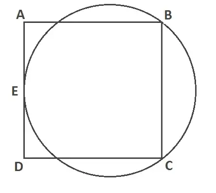

An exam for high school students had the following problem:
Let the point $E$ be the midpoint of the line segment $AD$ on the square $ABCD$. Then let a circle be determined by the points $E$, $B$ and $C$ as shown on the diagram. Which of the geometric figures has the greater perimeter, the square or the circle?
Of course, there are some ways to solve this problem. One method is as follows: assume the side lengths of the square is $1$, put everything somewhere on a Cartesian coordinate system, find the midpoint of the circle using the coordinates of $E$, $B$ and $C$, then find the radius of the circle, and finally use the radius to calculate the circle's circumference and compare it to the perimeter of the square.
The problem with that method is that ostensibly this problem is supposed to be very simple; it shouldn't require the student to know the formula for the midpoint of a circle given three coordinates. Therefore the question here is: does there exist a simple way to solve the problem without knowing any complicated geometric formulas?

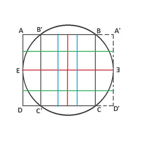

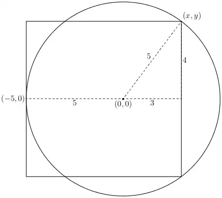

Perhaps the examiner intended the students to notice the square is determined by a $(3, 4, 5)$ triangle, because $3 + 5 = 4 + 4$ (!):
A circle and square
Consequently, as several others have noted, $$ \frac{\text{perimeter of the circle}}{\text{perimeter of the square}} = \frac{5 \cdot 2\pi}{4 \cdot 8} = \frac{\pi}{3.2} < 1. $$

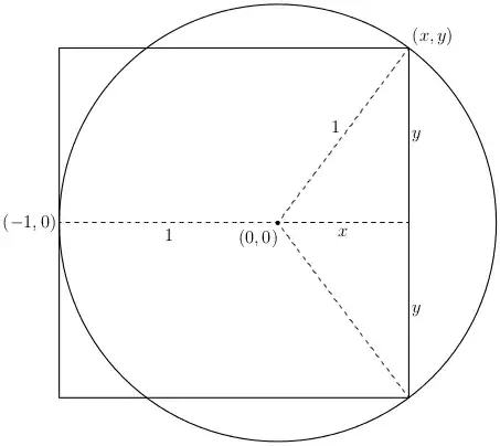

For an approach less dependent on inspiration, taking the origin of the coordinate system at the center of the circle seems easier than placing the origin at the center of the square. Without loss of generality, assume the circle has unit radius:
Expressing the dimensions of the square
Equating the lengths of the horizontal and vertical sides of the square in this diagram, we read off $$ x + 1 = 2y\quad\text{(or $x = 2y - 1$).} $$ Invoking the Pythagorean theorem and substituting the preceding line, \begin{align*} 0 &= x^{2} + y^{2} - 1 \\ &= (2y - 1)^{2} + y^{2} - 1 \\ &= 5y^{2} - 4y \\ &= y(5y - 4). \end{align*} Clearly $y \neq 0$, so $y = 4/5$, $x = 3/5$, and we notice the Examiner's Favorite Triangle.

    I like “Examiner's Favorite Triangle”, thanks! – MJD Mar 14 '15 at 17:19
  • 32
    This is a beautiful solution, so much so that it feels like the examiner started with the solution and worked backwards to the problem. Which isn't exactly fair to those taking the exam. (I certainly wouldn't have come up with it myself.) – fluffy Mar 14 '15 at 22:07
  • @fluffy: Your observation about the solution preceding the problem seems astute. :) (Incidentally, I worked out the answer by algebra as indicated, then noticed the triangle when $y$ turned out to be $4/5$; certainly didn't notice the triangle's dimensions at first glance....) – Andrew D. Hwang Mar 14 '15 at 22:32
  • 20
    'Notice the... (3,4,5) triangle'? Is there a quick observation that leads to that? Like the others, that seems to be an observation after all the calculations for the solution have been done. – Mitch Mar 15 '15 at 00:38
    @Mitch - The statement $3 + 5 = 4 + 4$ definitely isn't sufficient on its own, else I could make up something like $3.2 + 5 = 4.1 + 4.1$. We need to combine this constraint with the right triangle constraint. After getting those two constraints, I think OP is suggesting you might guess that 3/4/5 meets the constraints. (I personally wouldn't have jumped to this, though perhaps it's easier to guess if you just learned about Pythagorean triples.) – blah Mar 15 '15 at 06:10
    @Mitch: On the original unmarked figure, it's "reasonably natural" to draw the right triangle whose vertices are the center of the circle, the midpoint of the square's right edge, and the square's upper right corner. Given the prominent role of the $(3, 4, 5)$ triangle in school mathematics (and the observation $3 + 5 = 4 + 4$), it's conceivable that "lightning strikes" (i.e., the significance of the dashed lines becomes apparent). But I'm guessing that wasn't the "intended" approach; the indicated algebraic solution is well within the realm of "doable" for a school math test. :) – Andrew D. Hwang Mar 15 '15 at 12:51
    @user86418 I'm trying to see how 3/4/5 comes in a flash rather than through hard work. One flash would be as you say, to consider the center of the circle, rather than the square, and the sides of that triangle. But then how does one figure the units. Even if 5 for the radius, I do not see any flash that leads to 3 and 4 for the legs except blind guessing. Where does $x+1 = 2y$ come from, your very first step, without already knowing it's a 3/4/5 triangle? – Mitch Mar 15 '15 at 14:47
    @Mitch: Assuming a unit circle and denoting the "northeast corner" $(x, y)$, the horizontal sides of the square have length $x - (-1) = x + 1$ and the vertical sides have length $y - (-y) = 2y$. :) – Andrew D. Hwang Mar 15 '15 at 15:07
    @user86418: nice... that's the super simple start. But you should add that to the answer to make it complete (i.e. where $x+1 = 2y$ comes from, both $x+1$ and $2y$ equal a side of the square). – Mitch Mar 16 '15 at 02:25
  • If you set radius to r, half the side length to b, and a such that a+r=2b (distance from center of circle, to closest midpoint of square), then solve for a in terms of r and simplify fractions along the way, the 3,4,5 triangle falls out. No coordinate system needed, not assumption that something is unit distance. – Yakk Mar 16 '15 at 03:29
    I'd like to second @Mitch here; while this is a clever observation, the answer is missing the work that led to the observation. Without that context, I don't think this is a complete answer. – Sid Mar 16 '15 at 13:10
  • @Sid: Does the deduction starting from $x + 1 = 2y$ and $0 = x^{2} + y^{2} - 1$ seem lacking? That's the complete calculation I went through myself. (I can easily add my initial diagram, which looks just like the included diagram except without the dashed lines and side lengths, and with $E$ labeled $(-1, 0)$ rather than $(-5, 0)$; I omitted it because the same information can be read off the included diagram, and the included diagram seemed like the "right" ex post facto picture.) – Andrew D. Hwang Mar 16 '15 at 13:56
    @user86418 the derivation after $x+1=2y$ is elementary. Getting to that point is also elementary but missing; just say where it comes from (why +1? Why 2y?) – Mitch Mar 16 '15 at 14:24
  • Another way to see that it is a 3/4/5 triangle: a line drawn from (-1,0) to (1,1) intersects a unit circle at the point (4/5, 3/5). – DanielV Mar 16 '15 at 19:57
    While a fantastic answer - this still smacks of one of those horrible programming interview questions. Not one that you could work out, one the requires you to know the "trick" before hand. Which really makes it useless in measuring anything besides how familiar the student is with trick questions :( – Wayne Werner Mar 17 '15 at 12:57
    @WayneWerner: Thank you, I think. :) But note that I snuck two answers into one post. The second does seem like "fair game" even for a high-school math test. The first (the "magic trick") is my new object lesson in "P v. NP", illustrating the distinction between (i) obtaining an answer from scratch and (ii) checking that a prospective answer is correct. :) – Andrew D. Hwang Mar 17 '15 at 13:34
    There is nothing wrong with "magic trick" proofs. In fact, these are the best and most beautiful proofs - my favourite!
    When reading a good piece of poetry, one wouldn't complain if it hasn't included the words and ideas explored in each and every draft, only the final iteration matters.
    – wim Mar 18 '15 at 00:37

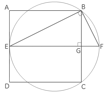

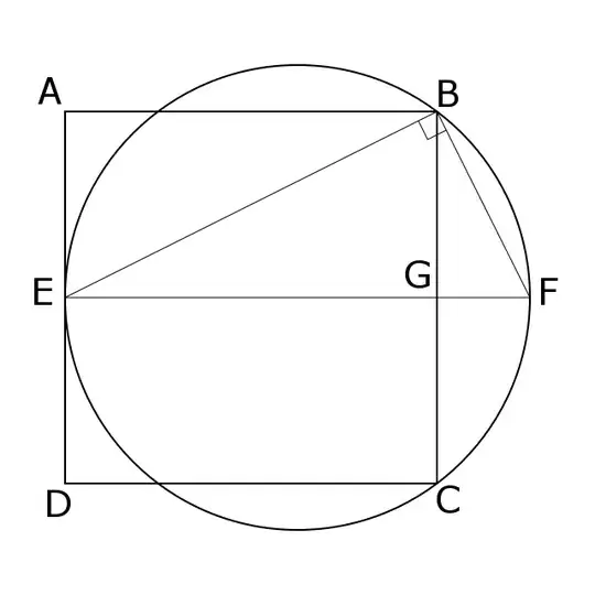

Here's a proof that arrives at the ratio of circle diameter to square side using similar triangles rather than the Pythagorean theorem:
Perimeter comparison
Draw the diameter of the circle from $E$; let the other endpoint of that diameter be $F$ and let it cross the square at $G$. Then since the angle $\measuredangle EBF$ is a right angle, the triangles $\bigtriangleup EBG$ and $\bigtriangleup BFG$ are similar. Obviously $|EG|=2|BG|$, so $|BG|=2|FG|$ (or in other words $|FG|=\frac12|BG|$) and so $|EF|=|EG|+|FG|=2|BG|+\frac12|BG|=\frac52|BG|$. From here the proof proceeds just like the others: the perimeter of the square is $4|EG|=8|BG|$ and the circumference of the circle is $\pi|EF|=\frac{5\pi}{2}|BG|$. From $\pi\lt\frac{16}5=3.2$, we get $5\pi\lt16$ and $\frac{5\pi}{2}\lt 8$, so the perimeter of the square is longer.

    I like this one because it follows a pattern (which is both standard and teachable) for solving elementary geometry: "Find similar triangles and expect everything else to follow". – Keith Mar 16 '15 at 02:52
    @Keith Thank you - my main goal was to find a solution that one could actually derive and not just 'happen upon' (which, as amazing as they are, most of the Pythagorean-based solutions feel like to me), and I think this hits that mark. – Steven Stadnicki Mar 16 '15 at 03:26
  • I find it interesting, indeed odd, that fewer have upvoted this entirely natural proof than the "3.4.5" trick. This proof almost writes itself when you think (1) "Hey, I'll surely need to compare a diameter of the circle with an edge" (2) "The obvious diameter to look at is the one through E" (3) "And if I'm going to comparing straight lines here, surely looking for similar triangles has to be the way to go ..."". – Peter Smith Mar 16 '15 at 15:00
    Nice solution; I (+1)ed yesterday, when both our answers had far fewer upvotes. :) Perhaps it's telling that despite being a geometer, I still find the result easier to see using coordinates (i.e., the second approach in my answer).... – Andrew D. Hwang Mar 16 '15 at 15:35
    @user86418 I use coordinates for a living, so I wholeheartedly understand that sentiment. :-) I really think the two solutions make a great complement for each other - though I'm still waiting for a 'clean' proof that $\pi\lt \frac{16}5$ (and I've been thinking of asking it as a separate question); Calum's is a nice one (and well deserving of upvotes) but uses too many pieces to (IMHO) really be clean. – Steven Stadnicki Mar 16 '15 at 16:14
    The most natural approaches (which involve chopping off the corner or symmetrically chopping off a couple of chunks) fall just short; I spent far too much time chopping off symmetric pieces yesterday only to discover that that approach can only get to $\pi\lt24-12\sqrt{3}\approx3.215$ - so close, and yet... – Steven Stadnicki Mar 16 '15 at 16:14
  • Since the pythagorean theorem can be proven from similar triangles, anything that can be proven using PT can be proven using similar triangles instead. – DanielV Mar 17 '15 at 01:44
    Even simpler: by the Intersecting Chord Theorem, BG × GC = EG × GF, or 1 × 1 = 2 × GF, or GF = 1/2. Therefore the diameter = 2.5, C = πd ≈ 7.85, perimeter of square = 4 * 2 = 8. – Tebbe Mar 17 '15 at 02:19
  • @Tebbe Nice! (I know comments are supposed to say more than this.) – Calum Gilhooley Mar 17 '15 at 07:26
  • This is the proof I found out. The other one is really clever a posteriori, but for me it was far easier to think in terms of similar triangles. – mau Mar 17 '15 at 11:04
  • @StevenStadnicki FYI, Googling the claim that $\pi<16/5$ returns a lot of results like this one: http://en.wikipedia.org/wiki/Indiana_Pi_Bill , so unfortunately any legitimate proofs tend to get drowned out. Note: according to that link, the proposal stated not only $\pi=3.2$, but also $\sqrt{2}=10/7$, which seems like an independent error (obviously wrong since 7-7-10 isn't a Pythagorean Triple). Also, some people may be interested in http://en.wikipedia.org/wiki/Proof_that_22/7_exceeds_%CF%80 , which proves a stronger result, though it's obviously not a geometry proof like you requested. – mathmandan Mar 18 '15 at 16:01
  • How do you know for certain that ∡EBF is a right angle? – curiousdannii Mar 21 '15 at 13:57
    @curiousdannii It's IMHO one of the 'core theorems' about circles in plane geometry: http://en.wikipedia.org/wiki/Thales'_theorem . – Steven Stadnicki Mar 21 '15 at 16:56

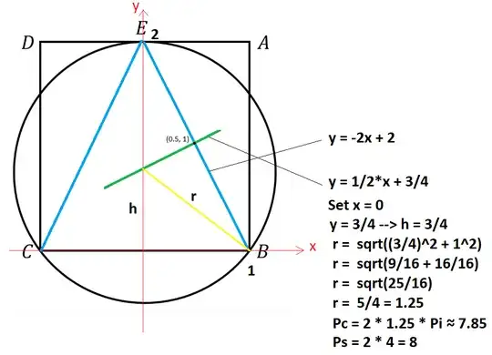

Regarding Abel's comment that he would like to see a less computational proof, consider the following. It is apparent that the length of a side of the square is $4$ small squares, and the perpendicular bisector of $EB$ crosses the horizontal centre line of the drawing $2.5$ small squares from $E$. Apologies for the inaccurate drawing.
More formally, if we call the centre of the square the origin:
EB has endpoints $(-2,0)$ and $(2,2)$ therefore it has midpoint $(0,1)$ and gradient $\frac12$.
The perpendicular bisector of EB has gradient $\frac{-1}{\mathrm{gradient\ of\ EB}}=-2$ therefore it crosses the $x$-axis at $(\frac12,0)$
Perimeter of ABCD = $16$
Perimeter of circle = $2 * \pi * 2.5 \approx 15.71$

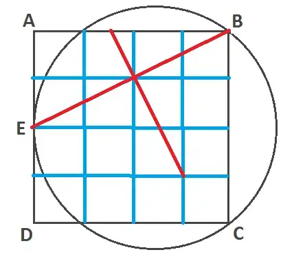

(I liked this answer so much I wanted to illustrate step-by-step the process of finding the location of the centre of the circle:
First, the centre of the circle is defined by intersection of diameters; one is obviously the line straight across from $E$, and the other is generated by the perpendicular from the midpoint of $EB$:
Then we can locate the midpoint of $EB$ as being halfway across the square and one-quarter down from the top:
Then we can find another point on the perpendicular by turning the rectangle from E to the midpoint through a right angle:
And it's then obvious that the radius of the circle is $\frac{5}{8}$ the side of the square.

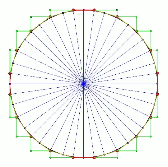

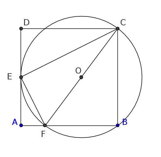

This isn't a full answer, just an observation to supplement the other answers (and celebrate Pi Day).
If you construct tangents at the 20 points $(0, \pm25)$, $(\pm25, 0)$, $(\pm15, \pm20)$, $(\pm20, \pm15)$, $(\pm7, \pm24)$, $(\pm24, \pm7)$ on the circle of radius 25 centred on the origin, they intersect at the vertices $(\pm\frac{25}{7}, \pm25)$, $(\pm25, \pm\frac{25}{7})$, $(\pm\frac{125}{11}, \pm\frac{250}{11})$, $(\pm\frac{250}{11}, \pm\frac{125}{11})$, $(\pm\frac{125}{7}, \pm\frac{125}{7})$ of an irregular circumscribing icosagon, whose perimeter is $8 \times \left(\frac{25}{7} + 2 \times \frac{625}{77}\right) = \frac{12200}{77} = 158\frac{34}{77} < 160,$ as required.
Comparing this with the circumference, $50\pi$, of the inscribed circle, we get the upper bound for $\pi$: $$ \pi < \frac{244}{77} = 3\frac{13}{77} < 3.17. $$
Here, the circumscribing icosagon is shown in red, with the circle (just) visible behind it in black.
The points of tangency are marked with smaller blue circles. The 16 right-angled triangles used in construction, shown in green, are all Pythagorean, in ratio 3:4:5 or 7:24:25, with hypotenuse $\frac{625}{77}$. The other 4 edges of the icosagon are of length $\frac{50}{7}$.
There is no need to calculate any angles, but the symmetry of the figure is illuminated by knowing the sequence of angles subtended at the centre of the circle. Running counter-clockwise from the positive $x$-axis to the positive $y$-axis, it is: $\underline{\alpha\alpha\beta\beta\alpha\alpha\beta\beta\alpha\alpha}$, where $\alpha = \tan^{-1}\frac{1}{7}$, $\beta = \tan^{-1}\frac{2}{11}$, and: \begin{gather*} 2\alpha = \tan^{-1}\frac{7}{24}, \ \alpha + \beta = \tan^{-1}\frac{1}{3}, \ 2\alpha + \beta = \tan^{-1}\frac{1}{2}, \\ 2\alpha + 2\beta = \tan^{-1}\frac{3}{4}, \ 3\alpha + 2\beta = \frac{\pi}{4}, \ 4\alpha + 2\beta = \tan^{-1}\frac{4}{3}, \\ 4\alpha + 3\beta = \tan^{-1}2, \ 5\alpha + 3\beta = \tan^{-1}3, \ 4\alpha + 4\beta = \tan^{-1}\frac{24}{7}. \end{gather*}
    Although not needed for the problem, lower bounds for $\pi$ are also easy to obtain from the figure. The inscribed icosagon gives $\pi > (6\sqrt{2}/5) + (16\sqrt{5}/25) > 3.128.$ Doubling the number of sides, using $2\sin\frac{\alpha}{2} = \sqrt{2 - 2\cos\alpha}$, etc., gives $\pi > (12\sqrt{50 - 35\sqrt{2}} + 8\sqrt{50 - 22\sqrt{5}})/5 > 3.138,$ but this is still not as good as Archimedes's amazing estimate of $\pi > 3\frac{10}{71}$ (along with $\pi < 3\frac{1}{7}$). – Calum Gilhooley Mar 16 '15 at 11:55

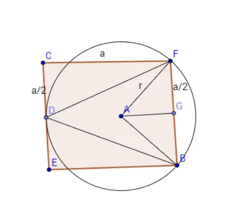

A pure geometric solution (I think it's the same as @baum's solution and others but with details and a clarifying drawing)
Let's consider that the length of the square is 1. We can easily deduct that the square perimeter is 4.
Let (HI) be a line perpendicular to (AD), with I being its intersection with the circle).
Since (AD) is tangent to the circle, [HI] is its diameter.
$ J\hat H B =90°-J\hat B H$ (angles of a right triangle)
$J\hat B I =90°-J\hat B H$ (they both form the angle $I\hat B H=90°$ because IBH is a right triangle (inscribed in a semicircle))
therefore $ J\hat H B = J\hat B I = \theta$
$\tan(\theta)=\frac{IJ}{BJ} =2\times x$
$\tan(\theta)=\frac{BJ}{HJ} =\frac{1\over 2}{1}=\frac12$ (BJ=AH=$\frac{AD}{2}$=$\frac12$ since H is the midpoint of [AD])
$2\times x=\frac12\Rightarrow x=\frac14$
d=HI=1+$\frac14$=$\frac54$
perimeter$=2\pi r=d\pi=\frac{5\pi}{4}$
Let's compare $\frac{5\pi}{4}$ and 4
$\frac{5\pi}{4}-4=\frac{5\pi-16}{4}=\frac54(\pi-\frac{16}{5})=\frac54(\pi-3.2)<0 \text{ because } 3.2>\pi$
So $\frac{5\pi}{4}$<4
Therefore the perimeter of the square is bigger

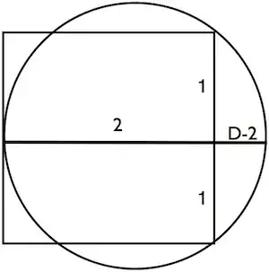

My apologies if this is already among the answers; I looked but didn't see it. (Update: Calum Gilhooley kindly informs me that it does appear among the answers, as a comment by Tebbe which simplifies Steven Stadnicki's answer.)
For convenience, let the sides of the square have length $2$. The horizontal midline of the square extends as a diameter of the circle:
By the intersecting chords theorem, we have
$$2(D-2)=1\cdot1$$
so $D=5/2$, and the inequality $\pi\lt3.2=16/5$ is enough to show
$$\pi D\lt 8$$
where $8$ is the perimeter of the square.

Using the Pythagorean theorem and the Quadratic Equation
  1. Use a unit circle. Radius of circle = 1, perimeter = 2 ~ 6.283.
  2. Center of circle = (0, 0). Point E = (-1, 0). Point B = (x, y).
  3. Perimeter of square = 4(1+x)=8y.
  4. 1 + x = 2y.
  5. 1 + 2x + x² = 4y².
  6. x² + y² = 1.
  7. 4y² = 4 - 4x².
  8. 1 + 2x + x² = 4 - 4x².
  9. 5x² + 2x - 3 = 0.
  10. x = (-2 ± √(4+60)) / 10 = (-2 ± 8) / 10 = (-2 + 8) / 10 = 0.6
    (We can rule out x = (-2 - 8) / 10 = -1, which is Point E.)
  11. y = 0.8
  12. 1 + x = 1.6 = 2 * y (also a check-by-substitution)
  13. Perimeter of square = 6.4 > Perimeter of circle ~ 6.283

    I might expect a high school student to prove division by $(r+a)$ is valid (neither are $\leq 0$). And $perimeter of square = 32/5 r = 6.4 r$ explicitly might make people happy. The ratio math to show that $6.4 > 2 \pi$ while cute might even be omitted at that point. – Yakk Mar 17 '15 at 13:39
11
You can solve this using just the quadratic formula and the equation of a circle, without bringing triangles, Pythagoras, or real geometric reasoning into it at all.
These are common enough hammers for all problems in high school, where everything turns out to be quadratic equations in disguise. Everything falls out nicely enough that it could even be what's intended.

Using standard exam guesses
This happens to boil down to a 3:4:5 right triangle, so guessing can be used to solve the problem.
  1. Use standard unit circle.
  2. Perimeter of unit circle = 2 ~ 6.283.
  3. Use standard unit circle (cartesian) coordinate system. Point E is at (-1, 0).
  4. Let point O be the center of the circle, at (0, 0).
  5. Let point F be the midpoint of the right side of the square.
  6. Consider a few possible shapes for the right triangle OFB:
45-45-90 right triangle
Does not work, because a square based on this triangle does not reach to the left edge of the unit circle.
30-60-90 right triangle
Height BC is √3.
Width AB=EF is 1.5.
Does not work, because it is not a square.
Height BC is 2 * 0.8 = 1.6
Width AB=EF is 1 + 0.6 = 1.6
Works; this is a square. Square perimeter = 6.4 > Circle perimeter = 2 ~ 6.283.
5:12:13 right triangle Don't need to evaluate, because the 3:4:5 right triangle solved the problem.
8:15:17 right triangle Don't need to evaluate, because the 3:4:5 right triangle solved the problem.
Jasper

You can show this with a ruler-and compass construction, in the spirit of Archimedes. Or, you can get the same result with simple trig and a calculator, measuring angles in degrees only, without using calculus or knowing the value of $\pi$.
As the other answers have shown, we are comparing the perimeters of a square of side 8 and a circle radius 5.
If we circumscribe a regular polygon with $n$ sides around a circle radius $r$ so that the circle touches the mid-point of each side, each side of the polygon is length $2r \tan (180/n)^\circ$ and the circumference of the polygon is $2nr \tan (180/n)^\circ$.
It is obvious (at high school level!) that the circumference of the polygon is longer than the circumference of the circle.
So, start by circumscribing a square around the circle, and keep doubling the number of sides till something interesting happens.
$r = 5$.
Square: $n = 4$, perimeter = $2 \times 5 \times 4 \tan 45^\circ = 40$, which is a sanity check when using the calculator, of course.
Octagon: $n = 8$, perimeter = $2 \times 5 \times 8 \tan 22.5^\circ = 33.1$.
16-gon: $n = 16$, perimeter = $160 \tan 11.25^\circ < 31.9$. So the inscribed circle perimeter is $< 31.9$, which is less than the perimeter of a square with side $8$.
For extra credit, get them to check this by making a scale drawing.

8
The problem is simply solved if the relative position of the center and the radius of the circle are known. The attached shows how they can be obtained.
Added:
Let the length of a side of the square be $L$. Then, the radius of the circle $= (\dfrac {5}{4}L) \times (\dfrac {1}{2})$.
$\dfrac {perimeter_{circle}}{perimeter_{square}} = ... = \dfrac {\pi}{3.2} \lt 1$.
Mick
  • 17,431
    This is good, but how do you know that AB' is exactly one quarter of AB? – curiousdannii Mar 15 '15 at 23:26
    @curiousdannii By symmetry. Notice that (1) this question was given to high school student; and (2) “this problem is supposed to be very simple; it shouldn't require the student to know the formula …… to solve the problem without knowing any complicated geometric formulas”. – Mick Mar 16 '15 at 05:47
    I've made use of your diagram in a comment on my own answer, proving that $AB' = A'B$ and $DC' = D'C$ - which I'd laboured to do before. Thank you for that! However, I don't understand how your diagram proves that $AB'$ is a quarter of $AB$. My argument also seemed to need a further step, in which I used Pythagoras to prove that the ratio is 4; was this step not necessary? – Calum Gilhooley Mar 16 '15 at 21:32
    @CalumGilhooley You are welcome to do so. There are many ways to prove AB’ = AB/4 but most of them are tedious. The shortest (but not the simplest) way to prove that is by “power of a point” which, unfortunately, could be beyond the OP’s intention. – Mick Mar 17 '15 at 04:17
    @CalumGilhooley To prove AB' = BA', we can do the following:- Let M and M’ be the midpoints of BC and B’C’ respectively. Then, AB’ = EM’ = ME’ = BA’. The middle equality comes from “Radius – distance from center to the midpoints of equal chords”. – Mick Mar 17 '15 at 04:42
    @curiousdannii To supplement my answer to your query, I have added two more comments (in replying Calum Gilhooley’s). See above. – Mick Mar 17 '15 at 04:50
    Funnily enough, I used the "distance from center to the midpoints of equal chords" argument in my first proof, but a different argument in the version inspired by your diagram! (+1) now that I understand your proof better (with a "d'oh!" moment when you mentioned the power of a point). – Calum Gilhooley Mar 17 '15 at 07:14

Another late entry (I just saw this question in the Hot Topics list), but I arrived at this solution before looking at the other answers. It roughly follows Sid's suggestion in the question; I don't think it's beyond the abilities of the high school students that the problem is aimed at.
Let the square's side length be 2, with the square centered on the origin, so the coordinates of the corners are (±1, ±1). B is (1, 1) and E is (-1, 0).
By symmetry, the centre of the circle M is on the X axis; let M be ($x$, 0).
Let $r$ be the radius of the circle.
$r = |ME| = x - -1 = x + 1$
By the Pythagorean distance formula:
$r^2 = |MB|^2 = (x - 1)^2 + (0 - 1)^2 = (x - 1)^2 + 1$
Thus $$\begin{align} (x + 1)^2 & = (x - 1)^2 + 1 \\ x^2 + 2x + 1 & = x^2 - 2x + 1 + 1 \\ 4x & = 1 \\ x & = \frac{1}{4} \\ r = x + 1 & = \frac{5}{4} \\ \end{align}$$
So the circumference $2\pi r = \frac{5\pi}{2}$. Now $\pi < \frac{22}{7}$ so the circumference is less than $\frac{5 \times 22}{2 \times 7} = \frac{55}{7}$, which is less than 8, the perimeter of the square.
No quadratic or obscure geometrical formulae required, nor the ability to magically see 3, 4, 5 triangles. :)

Redrawn diagram above. OP picture
The $\measuredangle$CDF is determined and is given by: $$\arctan(\frac{a}{a/2}) = 63.4 ^ \circ$$ Then the $\measuredangle$FDB can be determined as:
$(180 - 2\times63.4) ^ \circ = 53.2 ^ \circ$, because $\measuredangle$CDF is equal to $\measuredangle$EDB, and the three angles involved add up to $180^ \circ$.
We then have:
$\measuredangle$FAB is 2 times that of $\measuredangle$FDB by the incribed angle theorem.
$\measuredangle$FAG is 0.5 times that of $\measuredangle$FAB.
Hence, $\measuredangle$$FAG$ $=$ $\measuredangle$$FDB$ $=53.2 ^ \circ$.
Finally, in the right angled triangle FAG, we obtain the relationship between the radius $r$ and the side a of the square as: $$\sin\space(53.2 \space^ \circ) = \frac{a/2}{r}$$ From which it follows that: $1.25 \times a=2r$. Hence, the perimeter of the circle is $\pi 2r = 3.92 a$, which is less than $4a$, the perimeter of the square.

A little late to the party, but a slight variation:
I drew the same diagram as Steven Stadnicki, but used it differently to find the diameter of the circle:
Define $s = |AB|$, the length of a side of the square.
Draw the diameter from $E$, intersecting the square at $G$ and the circle at $F$. Clearly $|EG|=s$ and $|BG| = s/2$.
Consider the triangles $\triangle EBG$ and $\triangle EBF$. These are both right angle triangles with the common angle at $E$, so are similar. Therefore $\dfrac{|BE|}{|EG|} = \dfrac{|EF|}{|BE|}$, so $ |EF| = \dfrac {|BE|^2}{s}$.
By Pythagorus, $|BE|^2 = s^2 + (\frac{1}{2}s)^2 = \frac{5}{4}s^2$. So $|EF| = \frac{5}{4}s$.
Then the perimeter of the square, $4s = \frac{16}{5}\frac{5}{4}s = 3.2\frac{5}{4}s$, is greater than $\pi\frac{5}{4}s$, the perimeter of the circle.

In this solution the green line is a perpendicular bisector of the blue line. Thus it intersects the y-axis at the center of the circle.
(Sorry for using absolute size of everything. I beg your indulgence in this regard. The idea should still be clear, if not clearer.)
