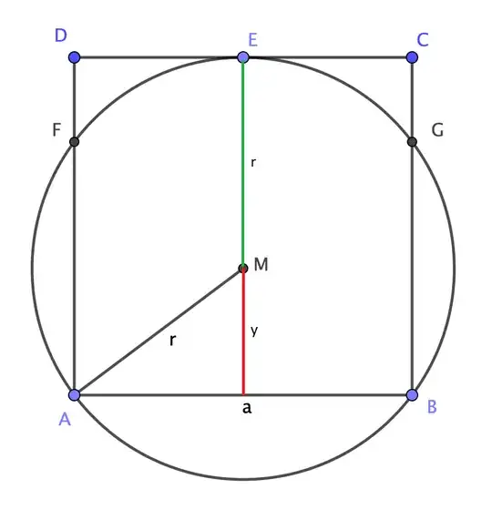

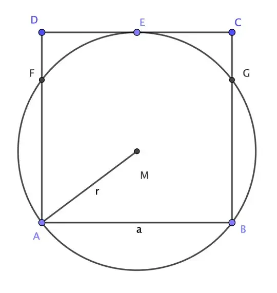

The problem is the following
Consider a square $ABCD$ with side $[AB]=a$ and a circumference $\omega$ with radius $r$, such that both are "semi inscribed" in each other (the image below might clarify this).
Proof that the following relation holds $$a=\frac{8r}{5}$$

Consider the isosceles triangle $\Delta ABE$ inscribed in $\omega$.
It suficies to use the Pythagorean theorem and the relation $$R=\frac{abc}{4S} $$ in order to prove the statement.
An analytic approach might be also helpful (let $A$ be the origin of coordinates). The rest is just a matter of solving equations (quite simple).

I find the following quite instructive:
Obviously \begin{align} a&=r+y \\ &=r+\sqrt{r^2 - \left(\frac{a}{2}\right)^2} \end{align} and solving gives $$\frac{r}{a} = \frac{5}{8} \, .$$
circle in square and vice versa

Let $I$ be the midpoint of $[AB]$. Use the Pythagorean theorem in triangle $AIM$: $$r^2=\dfrac{a^2}{4}+(a-r)^2$$ to deduce $a=8r/5$.

Let P be the middle of AB, then AE=$\sqrt{5}/2$ from triangle AEP. Let Q be the middle of AE, then EQ=$\sqrt{5}/4$, and from similarity of triangles AEP and MEQ you get the answer.
