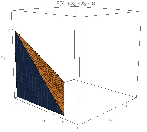

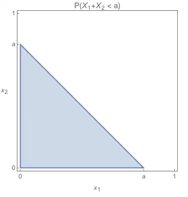

Let $X_1, X_2, \dots$ denote successive random draws from a Uniform(0,1) parent, where the sample is terminated as soon as the Irwin-Hall sum $X_1 + X_2 + \dots + X_n > a$ is attained. [To avoid notational confusion, I am using $a$ (rather than $x$) for the target sum.] Importantly, it is given that $0< a< 1$. Then:
  • $P(N>1) = P(X_1 < a) = a$
  • $P(N > 2) = P(X_1 + X_2 < a) = \frac{a^2}{2}$ i.e. the area defined by the isosceles right triangle:
In each case, to advance to a higher dimension, we multiply the preceding probability by $P(X<a)=a$ and divide by the number of 'sides' ($n$) i.e. $$P(N>n) = \frac{a}{n} P(N>n-1) \quad \text{ and so } \quad P(N>n) = \frac{a^n}{n!}$$
