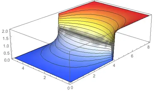

Symmetry dictates that the solution should satisfy $u(a/2,y)=V_0/2$ for $0<y<b$. Thus, we first, consider the problem $$\Delta u=0, \: u(0,y)=u(x,0)=u(x,b)=0, \text{ and } u(a/2,y)=V_0/2.$$ This problem can be solved by separation of variables and Fourier series; we obtain $$ u(x,y) = \frac{1}{2} V_0 \sum _{n=0}^{\infty } \frac{4 \, \text{csch}\left(\frac{(2 n+1) \pi a}{2 b}\right) \sin \left(\frac{(2 n+1) \pi y}{b}\right) \sinh \left(\frac{(2 n+1) \pi x}{b}\right)}{(2 n+1) \pi }. $$ Note that it is very easy to see that $u$ is harmonic and that the 3 zero boundary conditions are satisfied. The coefficients are chosen to satisfy the remaining boundary condition.
With this part in hand, we can define $$u(x,y) = V_0-u(a-x,y)$$ for $a/2<x\leq a$. For $a=8$, $b=5$, and $V_0=2$, the solution looks like so:

  • Many thanks! Could you comment on U(x,y=b/2)? Can it be a simple form function? – Roy Jan 22 '15 at 04:25
  • @Hesam You can just set $y=b/2$ in $u(x,y)$ to get that curve. I see no reason to think that the result can be substantially simplified. – Mark McClure Jan 22 '15 at 04:27
  • Lets assume a >> b, then we have mainly the first term (n=0) which is sinh(c x) (since csch decays fast and a is large). But sinh doesn't look like a correct answer if we look into its shape. – Roy Jan 24 '15 at 19:03
