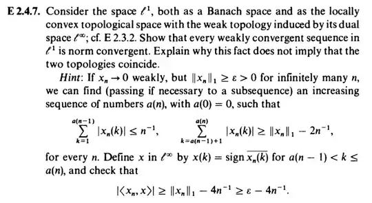

    Indeed, the proof outlined in Pedersen's Analysis Now, Exercise E 2.4.7, page 68 goes through as well as the proof that $\ell^\infty$ is the dual space of $\ell^1$ (thanks to Brian M. Scott and Asaf Karagila for double-checking this). For the convenience of the reader here's the argument which is basically the same as the one given by Davide Giraudo in this thread:
    Pedersen, E 2.4.7
    The point is that the sequence $a(n)$ and the subsequence of $(x_n)$ can be simultaneously and explicitly defined by induction using the well-order on $\mathbb{N}$, the hypothesis that $x_n$ converges weakly to zero, that $x \mapsto \sum_{k=1}^{a(n-1)} |x(k)|$ is weakly (sequentially) continuous and that $\|x_n\|_1 \geq \varepsilon$ infinitely often.
