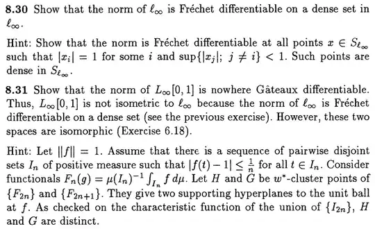

A more explicit and probably more elementary approach is outlined in these two exercises from page 268 in M. Fabian, P. Habala et al. Functional Analysis and Infinite-Dimensional Geometry, Springer 2001, depending on recognizing points of differentiability of the norms:
Exercises 8.30 and 8.31

  • @NateEldredge: I found a nice pair of exercises in Fabian et al. containing a probably more accessible argument. See the second part of the answer. – commenter Jun 29 '13 at 21:37
