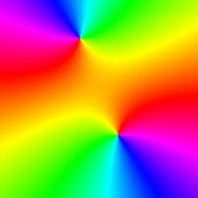

You can use domain coloring:
The two roots can be seen clearly: they are the points having a rainbow around it.
