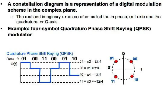

    For example: the main algorithms we use for encoding and decoding digital communication are based on complex numbers: DSSS (WiFi), OFDM (4G), and QAM (HDTV). Without i, a lot of the stuff that these kids love wouldn't work.
    – Foo Bar Dec 27 '14 at 14:47

Here's a weird name that most students have never heard of: Quadrature Phase Shift Keying (QPSK). It's a way to convert data into a signal that can be transmitted on radio waves. Many important technologies use QPSK or its siblings:
  • Direct Sequence Spread Spectrum (DSSS)
  • Orthogonal Frequency Division Multiplexing (OFDM)
  • Quadrature Amplitude Modulation (QAM)
Huh, you haven't heard of those either? Okay, what about these names:
  • WiFi, which uses DSSS
  • 3G and 4G, which use OFDM
  • HDTV, which uses QAM
Show of hands, how many of you use a laptop, or a tablet, or a smartphone, or a TV? I see hands from 1, 2, 3, ... everyone in the room. Congratulations, you are relying on complex numbers.
page 19 of www.ieee.li/pdf/viewgraphs/ introduction_to_orthogonal_frequency_division_multiplex.pdf
QPSK takes two bits of data and uses a table to convert it into a complex number, which is then transmitted as a phase shift (from Euler's formula $e^{i\theta} = \cos \theta + i \sin \theta$). Sending two bits isn't much, but when a radio chip does that over and over, millions of times per second, it adds up to a lot of useful stuff: email, videos, apps, cat gifs, etc. At the receiving end, a chip does it all in reverse, converting the radio wave into complex numbers, and from there back to the original data.
This rigamarole is necessary to make the signals better at handling interference. It's how so many people can use WiFi or 4G or whatever at the same time, without the signals drowning each other out. Imagine you're with a hundred people standing in the gym, holding 50 different conversations, but the person you're talking to is on the other side of the room. Complex numbers are part of the process that lets your device pick out the tiny handful of radio waves that it needs from the huge mass of noise.

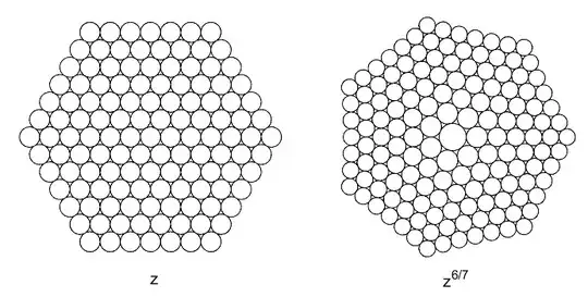

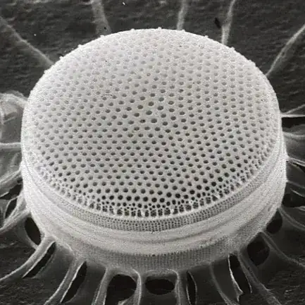

Here is graphical example I have seen (but I don't remember where) and that I have programmed.
It deals with a rather special modelization
Consider the following photograph taken from this article. It represents the skeleton of a particular species of diatom (I will not enter into the details).
As you can see, the surface has holes arranged according to an hexagonal structure (each hole has 6 neighbors) but for the central hole which has 7 neighbors. How is it possible to realize a modelization of this structure ?
Very simply by taking the power $6/7$ of a regular hexagonal structure as represented on the left image below which to the central circle (which is invariant) to have $7$ neigbours without impairing the 6-neighbourhood of all other circles.
Jean Marie

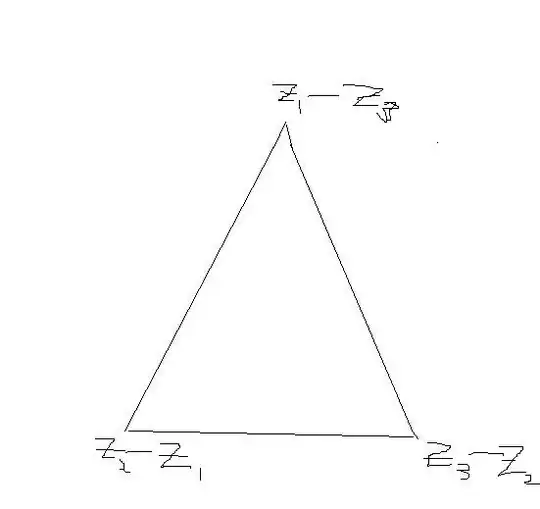

Complex numbers can be used to give a very simple and short proof that the sum of the angles of a triangle is 180 degrees. Construct a triangle in the plane whose vertices are complex numbers z1.z2 and z3 in the plane.
Recall that the angle $\theta$ at a vertex like $ABC$ is the angular part $\theta$ of $(C-B)/(A-B) = r\exp(i\theta)$. It is written $\theta = \arg(r\exp(i\theta))$ and is defined only modulo $2\pi$, although conventionally a representative in the interval $(-\pi, \pi]$ is taken.
Now recall that $\arg(z w) =\arg(z) + \arg(w)$ for any nonzero complex numbers $z$ and $w$: this follows immediately from the multiplicative property of the exponential, $\exp(i\theta)\exp(i\phi) = \exp(i(\theta + \phi))$.
The sum of the three angles at vertices $Z1$, $Z2$, and $Z3$ is obtained merely by rearranging the product of three numbers in the denominator of a fraction. So now:
$$\eqalign{\arg\frac{Z2-Z1}{Z3-Z1} + \arg\frac{Z3-Z2}{Z1-Z2}+\arg\frac{Z1-Z3}{Z2-Z3} &= \arg\left(\frac{Z2-Z1}{Z3-Z1}\frac{Z1-Z3}{Z2-Z3}\right) \\ &= \arg\left(\frac{Z2-Z1}{Z1-Z2}\frac{Z3-Z2}{Z2-Z3}\frac{Z1-Z3}{Z3-Z1}\right) \\ &= \arg\left(-1^3\right) = \arg(-1) \\ &= \pi. }$$
Ligget se. I'll always remember Ravi Kulkarni showing us this trick at the end of one of his lectures and quoting his granddaughter, "Cool." I hope your students agree-especially if they've just been tortured with the painfully tedious classical proof of the result.
