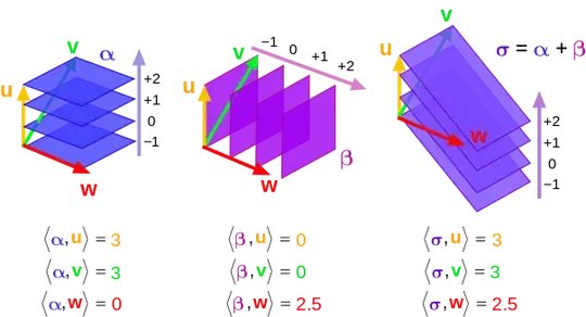

Consider this picture of two 1-forms and their linear combination:
DIAGRAM $1$ DIAGRAM 1
How does a 1-form "eat" a vector? It's merely the number of planes a vector pierces. So for the picture on the left, our 1-form is $\alpha$. Now, let's plug the vectors into $\alpha$. $w$ yields $0$ because it doesn't pierce through any. If we imagine the blue planes each as an $xy$ plane, $w$ lies in the plane and therefore doesn't extend along the $z$ dimension. In contrast, although $u$ and $v$ are very different vectors, they yield the same value because the number of planes they pierce is the same. Think about it. Going back to my $x,y,z$ coordinates, the $z$ component of $v$ is the same magnitude of $u$. So, since this is the only part of the vector that $\alpha$ cares about, it spits out the same value for both.
Similar logic applies to the middle diagram. We have now a 1-form $\beta$ which is now equivalent to $zy$ planes along the $x$-axis. Notice the vectors $u$, $v$ and $w$ are the same. So nothing has changed about their definition. It's because we are using a different 1-form that we now get different results. In this case, $\beta$ only eats the components of vectors laying along my $x$-axis. Since $w$ lies entirely along the $x$-axis (and given the scaling in the pictures), we get 2.5. But notice how neither $u$ nor $v$ have components in the $x$ direction. Therefore, when we plug them into $\beta$ we get $0$ because they don't pierce any planes.

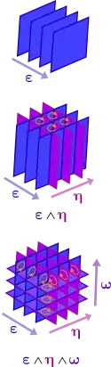

Consider this picture of a 2-form:
DIAGRAM $2$
Here's where I was confused. You see this picture of a two form in the middle of Diagram 3. Notice how it is just two sets of consecutive planes intersecting each other. But seemingly these aren't added together or anything like that. Vector operations like multiplying by scalars and addition of one-forms correspond to the rightmost diagram in Diagram 2. But the planes in the middle diagram of Diagram 2 aren't added/combined together in that way. Otherwise, we would just get a diagram like the rightmost one in Diagram 2. Instead, they constitute a new object: a 2-form. We now have a new operation that allows us to define combinations of one-forms called the wedge product $\wedge$, whatever that means. But we now can at least see that there is a difference between just adding one-forms and combining them to make a two-form. Now, the bottom diagram of Diagram 2 makes perfect since. By combining three 1-forms together, we get a three form. But we don't combine them in the sense of vectors. We do it using this wedge product operation.

  • I find it natural to depict the 2-form $\varepsilon\wedge\eta$ in your second picture as the intersection of the planes representing $\varepsilon$ with the planes representing $\eta$. This results in a set of parallel lines equally distributed across all space, and nicely fits with the interpretation that "applying a p-form on a p-vector gives the number of hypersurfaces pierces by the p-vector". In our easily visualizable case of 3 dimensions, a 2-form (set of lines) eats a bivector and gives the number of intersection points between them. – Al.G. Dec 27 '21 at 12:11
  • What I described you can find in more details Jules' answer to this question: https://math.stackexchange.com/q/440816/293177 – Al.G. Dec 28 '21 at 14:36
