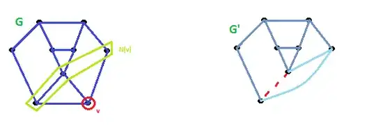

We approach this problem via induction on the number of vertices, $|V|$. Trivially, the claim is true when $|V|\leq 3$.
Assume for our induction hypothesis that all graphs on strictly fewer than $n$ vertices satisfies the claim that there exists some partition into two sets of vertices where the induced subgraph on each is such that every vertex is of even degree. Consider then what happens for arbitrary $G$ when $|V(G)|=n$.
We may assume that $G$ contains at least one vertex of odd degree (if not, then take $V_1 = V$ and $V_2 = \emptyset$, trivially satisfying the claim). Pick one such vertex of odd degree and label it $v$. Take note of the neighborhood of $v$ and label it $\mathscr{N}(v)$.
Construct a new graph from the original defined as: $G' = (V(G)\backslash\{v\}, \{(x,y):~x\neq y, (x,y)\in E(G\backslash \mathscr{N}(v))\cup (E(\mathscr{N}(v)))^c\})$
That is to say, to form $G'$, invert the adjacency relationships between members of $\mathscr{N}(v)$, delete $v$, and retain the rest of the graph the way it was in $G$.
Example

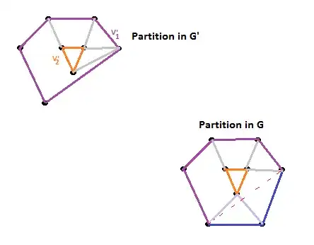

Now, $G'$ has fewer vertices than $G$ and by our induction hypothesis has some partition $V_1', V_2'$ such that all vertices in the induced subgraphs from $G'$ are of even degree.
Define $A = V_1'\cap \mathscr{N}(v)$ and define $B = V_2'\cap \mathscr{N}(v)$
As $v$ was selected to be of odd degree, precisely one of $|A|$ or $|B|$ will be of even size. Without loss of generality, assume it was $A$.
Returning now to the original graph, consider the partition $V_1 = V_1'\cup\{v\}$ and $V_2 = V_2'~~~~~$ (note, if it had been $B$ which was of even size, attach $\{v\}$ to $V_2$ instead)
partitioned
