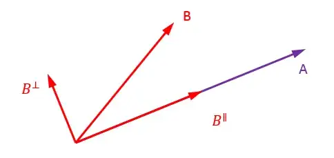

Consider two vectors $A$ and $B$. By projecting on $A$, decompose $B$ in a parallel and a normal component.
As regards the modules (lengths),
  • the dot product is the product of $A$ and $B^\parallel$,
  • the cross product is the product of $A$ and $B^\perp$. enter image description here
What can you conclude when $B^\parallel=0$ or $B^\perp=0$ ?
