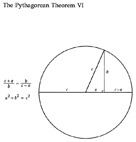

How does the attached figure prove the Pythagorean theorem? enter image description here

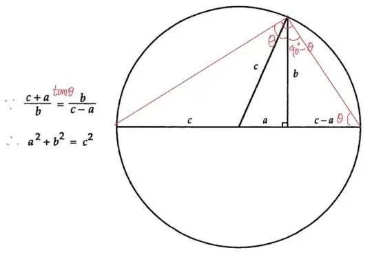

I think the diagram ought to include lines that connect all the three points on the large circle into a triangle. It is then (I think) supposed to be known that an inscribed triangle that has a diameter as one of its sides is right, and that an altitude towards the hypotenuse divides a right triangle into two similar triangle. The proportion $\frac{c+a}{b}=\frac{b}{c-a}$ then comes from these two similar triangles. Cross multiplying with the denominators produces $c^2-a^2=b^2$.
  • From elementary level geometry, we know that an inscribed angle whose endpoints are a diameter is 90 degrees (because it's half the corresponding central angle). And we also know that a perpendicular line from the right angle to the hypotenuse creates two similar triangles (the two triangles have a right angle and share an angle with the big triangle). – Jeff Feb 18 '12 at 02:55

I think the picture is missing two more lines: those connecting all the points on the circle. Once these segments are drawn, we see two important right-angled triangles: one has sides $c+a$, $b$ and the hypotenuse; the other has sides $c-a$ and $b$ and the hypotenuse. A quick counting of angles shows that these two triangles are similar, hence we obtain the ratio written on the left: $$ \frac{c+a}{b} = \frac{b}{c-a}. $$ And the theorem follows from this ratio by 'cross multiplying'.

  • When you said "all the points on the circle", I didn't know what you meant. I thought you meant every point that's on the circle, not all the points where the drawn lines intersect the circle. D'oh! :D. I have to think about how we know those two triangles are similar. – Jeff Feb 18 '12 at 01:50

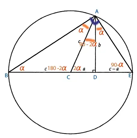

I will try to complete the answer of @Rick. The two triangles ABD and ADE are the same because both have the same angles 90, alpha and 90-alpha.
And we have $Cotangent(alpha) = \frac{BD}{DA} = \frac{AD}{DE} = \frac{c+a}{b} = \frac{b}{c-a}$

  • It is not so clear why $\angle BAE = 90 ^\circ$ but we can use several relations for this. $\angle ABC = \angle BAC$, $\angle CAE = \angle ACE$, $\angle BCA + \angle ACD = 180 ^\circ$, $\angle CAD + \angle ACD = 90 ^\circ$ and $\angle DAE + \angle AED = 90 ^\circ$ – Sextus Empiricus Mar 03 '20 at 22:28
  • It is the Thales's theorem : if A, B, and C are distinct points on a circle where the line AC is a diameter, then the angle ∠ABC is a right angle. (https://en.wikipedia.org/wiki/Thales%27s_theorem) but thanks for your clarification. I think you just proved this theorem – ihebiheb Mar 04 '20 at 18:30

You can get the first statement by a number of methods: one is the use of similar triangles (connect the ends of the diameter to the other point: this is Euclid's Book VI Proposition 8 which he used to prove Pythagoras's theorem in VI.31)
Another is that for two intersecting chords of a circle the product of the two parts of one chord is equal to the product of the two parts of the other (extend the vertical half-chord: this is Euclid's Book III Proposition 35 and he uses Pythagoras's theorem in I.47 to prove it).
The first statement implies $c^2-a^2=b^2$ and then all you need a slight rearrangement.
