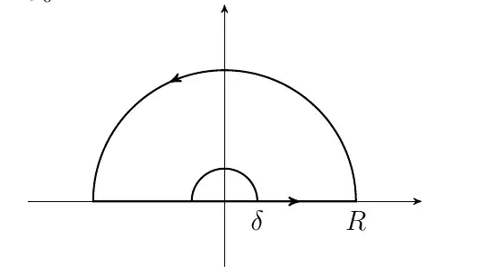

For this integral, you want to define you branch cut along the negative x axis and use a contour with a semi circle around the origin. enter image description here
Also, note we are taking the real Cauchy Principal value. Then $$ \int_0^{\infty}\frac{(\ln(z))^2}{1+z^2}dz = \int_{\Gamma}f(z)dz+\int_{\gamma}f(z)dz + \int_{-\infty}^0f(z)dz + \int_0^{\infty}f(z)dz $$ Let $R$ be the radius of big semi circle, $\Gamma$ and $\delta$ the radius of the small semi circle $\gamma$. When $R\to\infty$, $\int_{\Gamma}\to 0$ and $\int_{\gamma}\to 0$ when $\delta\to 0$ by the estimation lemma. Then $$ \int_{-\infty}^0f(z)dz + \int_0^{\infty}f(z)dz = 2\pi i \sum\text{Res}_{\text{UHP}} $$ where UHP is the upper half plane. There is only one pole in the upper half plane and that is $z = i$ $$ \text{Re PV}\biggl[\int_{-\infty}^0\frac{(\ln|z| + i\pi)^2}{z^2+1}dz + \int_0^{\infty}\frac{(\ln|z| + i\cdot 0)^2}{z^2+1}dz\biggr] = 2\pi i\sum\text{Res}_{\text{UHP}} $$ Recall that $\ln(z) = \ln|z| + i\arg(z)$. Can you take it from here?
Mouse over for solution.
\begin{align}\text{Re PV}\biggl[\int_{-\infty}^0\frac{\ln^2|z| + 2\pi i\ln|z| - \pi^2}{z^2 + 1}dz +\int_0^{\infty}\frac{\ln^2|z|}{z^2 + 1}dz\biggr]&= 2\pi i\lim_{z\to i}(z - i)\frac{(\ln|z| + i\pi/2)^2}{z^2+1}\\2\int_0^{\infty}\frac{\ln^2(x)}{x^2 + 1}dx - \pi^2\int_0^{\infty}\frac{dx}{x^2+1} &= -\frac{\pi^3}{4}\\2\int_0^{\infty}\frac{\ln^2(x)}{x^2 + 1}dx - \frac{\pi^3}{2} &= -\frac{\pi^3}{4}\\\int_0^{\infty}\frac{\ln^2(x)}{x^2 + 1}dx &= \frac{\pi^3}{4} - \frac{\pi^3}{8}\\&= \frac{\pi^3}{8}\end{align}
