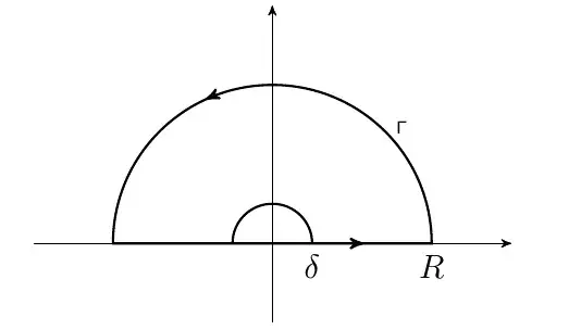

I recently had an extremely failed attempt at asking the same question, so I am posting the same question more or less to hope that someone can give me feedback.
Consider the integral:
$$\int_{0}^{\infty} \frac{\log^2(x)}{x^2 + 1} dx$$
$\hskip1in$Log contour
Image taken and modified from: Complex Analysis Solution (Please Read for background information).
$R$ is the big radius, $\delta$ is the small radius.
Actually, lets consider $u$ the small radius. Let $\delta = u$
Ultimately the goal is to let $u \to 0$
We can parametrize,
$$z = ue^{i\theta}$$
$$\int_{\delta} f(z)dz = (-)\cdot\int_{0}^{\pi} \frac{(i\theta + \log(u))^2\cdot (uie^{i\theta})}{(ue^{i\theta})^2 + 1} d\theta$$
$$\left | \int_{0}^{\pi} \frac{(i\theta + \log(u))^2\cdot (uie^{i\theta})}{(ue^{i\theta})^2 + 1} d\theta \right | \le \int_{0}^{\pi} \frac{|(i\theta + \log(u))|^2\cdot(u)}{|(ue^{i\theta})^2 + 1 |} d\theta$$
$$|(ue^{i\theta})^2 + 1 | < u^2 + 1 $$
$$\frac{1}{u^2 + 1} < \frac{1}{|(ue^{i\theta})^2 + 1 |}$$
Since the maximum value of $\theta$ is $\theta = \pi$
$$|(i\theta + \log(u))| = \sqrt{\log^2(u) - \theta^2} \le \sqrt{\log^2(u) + \pi^2}$$
So:
$$|(i\theta + \log(u))|^2 \le \log^2(u) + \pi^2$$
Then:
For values $u$ near $0$.
$$(u)|(i\theta + \log(u))|^2 \le (\log^2(u) + \pi^2)u \le (\pi^2)u + 5\pi^2$$
Therefore,
$$\frac{|\log(z)|}{|z^2 + 1|} \le \frac{(\pi^2)u + 5\pi^2}{u^2 + 1}$$
Then we take the limit as $u \to 0$ which makes the RHS of the inequality 0.
hence the LHS upperbound is $0$.
So is the contour integral around the small semi circle $\delta = 0$?
How do I do this?
Thanks
Amad27
  • 11,551

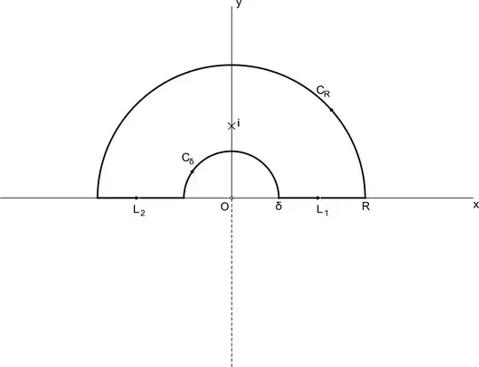

  • @Amad27 do you know what a branch is? – Aaron Maroja Dec 25 '14 at 12:13
  • @AaronMaroja, vaguely yes. Because of multivalue, you pick on branch, meaning one angle range like. $0 \le theta \le 2\pi$ – Amad27 Dec 25 '14 at 12:15
  • It's a single valued function $F$ that is analytic in some doamain, and at each point $z$ the value $F(z)$ is one of the values $f(z)$. Now a branch cut, is a line or curve in which every in it point is singular point of $F$ (branch). In the complex logarithmic the origin and the $ray \theta = \alpha$ make up the branch cut, if you write $\ln z = \ln r + itheta$, where $-alpha < \theta < \alpha + 2\pi$. – Aaron Maroja Dec 25 '14 at 12:24
  • You may be used to the principal branch $-\pi<\theta<\pi$. Here on this case, we change the branch, and also the branch cut to $Ray\ \theta = \frac{\pi}{2}$, consisting of the origin and the negative imaginary axis. Like a I showed in the picture. – Aaron Maroja Dec 25 '14 at 12:27
We want to show that $$\int_{0}^{\infty}\frac{\ln^2 x}{x^2+1} = \frac{\pi^3}{8} \tag{1}$$
Breaking through, let's take $f(z) = \frac{\ln z}{z^2+1}$ with branch $\Big(|z|> 0 -\frac{\pi}{2} < \arg z < \frac{3\pi}{2}\Big)$ of the multiple-valued function $\ln z / (z^2+1)$. As long as we are isolating $z = i$ we're going to take $\delta < 1 < R$. According to Cauchy's Residue Theorem,
$$\int_{L_1} f(z)dz + \int_{C_R} f(z)dz + \int_{L_2} f(z)dz + \int_{C_\delta} f(z)dz= 2\pi i Res_{z=i}f(z)$$
That is,
$$\int_{L_1} f(z)dz + \int_{L_2} f(z)dz = 2\pi i Res_{z=i}f(z) - \int_{C_R} f(z)dz - \int_{C_\delta} f(z)dz \tag{2}$$
Since $$f(z) = \frac{(\ln r + i\theta)^2}{r^2e^{i0} + 1} \ \ \ \ \ \ (z=re^{i\theta})$$
the parametric representations
$$z = r e^{i0} = r \ \ (\delta\leq r\leq R) \ \ \text{and}\ \ z = re^{i\pi} = -r \ \ (\delta\leq r \leq R)$$
for the legs $L_1$ and $-L_2$ can be used to write the LHS pf equation $(2)$ as
$$\int_{L_1} f(z)dz - \int_{-L_2} f(z)dz = \int_{\delta}^{R} \frac{\ln^2 r}{r^2 + 1}dr + \int_{\delta}^{R} \frac{(\ln r + i\pi)^2}{r^2 + 1}dr$$
Also, since
$$Res_{z=i}f(z) = \frac{p(z)}{\phi'(z)}\ \ \text{where}\ \ p(z) = \ln^2 z \ \ \text{and}\ \ \phi(z) = z^2 + 1$$
then
$$Res_{z=i}f(z) = \frac{\Big(\ln (1) + i\frac{\pi}{2}\Big)^2}{2i}$$
Thus equation $(2)$ becomes
$$\begin{align}&2\int_{\delta}^{R} \frac{\ln^2 r}{r^2 + 1}dr + 2\pi i\int_{\delta}^{R} \frac{\ln r }{r^2 + 1}dr - \pi^2\int_{\delta}^{R} \frac{1}{r^2 + 1}dr\\ & = 2\pi i \frac{\Big(\ln (1) + i\frac{\pi}{2}\Big)^2}{2i} - \int_{C_R} f(z)dz - \int_{C_\delta} f(z)dz \\ &= -\frac{\pi^3}{4} - \int_{C_R} f(z)dz - \int_{C_\delta} f(z)dz \end{align}$$
Evaluating integrals
1- $\lim_{\delta \to 0}_{R\to \infty}\int_{\delta}^{R} \frac{\ln r }{r^2 + 1}dr = 0$
2- $\lim_{\delta \to 0}_{R \to \infty}\int_{\delta}^{R} \frac{1}{r^2 + 1}dr = \frac{\pi}{2}$
3- $\lim_{R\to\infty}\int_{C_R} f(z)dz = 0 $
4- $\lim_{\delta \to 0}\int_{C_\delta} f(z)dz = 0 $
Showing $4$.
Take $z = \delta e^{i\theta}$. Notice that if $\delta < 1$ and $z = \delta e^{i\theta}$, $$\begin{align}|\log^2 z| &=|(\ln \delta + i\theta )^2| = |\ln^2\delta + 2i\theta\ln\delta - \theta^2|\\&\leq |\ln^2\delta| + 2|i\theta\ln\delta|+\theta^2 \leq \ln^2\delta -2\pi\ln \delta + \pi^2\end{align}$$ and $$|z^2+1| \geq ||z^2| - 1| = 1 - \delta^2$$ then
$$\Bigg|\int_{C_\delta} f(z)dz\Bigg| \leq \int_{C_\delta} |f(z)| |dz| \leq \frac{\ln^2\delta -2\pi\ln \delta + \pi^2}{1 - \delta^2} \pi\delta$$
the RHS of the inequality goes to $0$ as $\delta \to 0$.
There fore we get
$$2\int_{0}^{\infty} \frac{\ln^2 r}{r^2 + 1}dr = \frac{\pi^3}{4} \Rightarrow \int_{0}^{\infty} \frac{\ln^2 r}{r^2 + 1}dr = \frac{\pi^3}{8}$$
Aaron Maroja
  • 17,869
