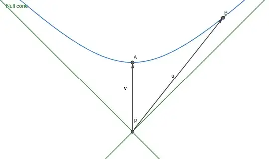

Let $(M, g)$ denote a Lorentzian surface and consider some point $p \in M$. The scalar curvature of $M$ at $p$ determines how two unit-speed timelike geodesics with velocity vectors $v$ and $u$ passing through $p$ are spreading out (see picture). Relatedly, it also determines the rate of growth of the area of a "geodesic sector" centered on $p$, and of the length of the curve swept out when varying a given radial geodesic through an angle without changing its "length" (which is analogous to an arc of a geodesic circle). The sign of the curvature has the opposite effect in the Lorentzian case, however (see below).
More precisely: Consider $e_1, e_2 \in T_p M$ satisfying $g_p(e_1, e_1) = 1$, $g_p(e_2, e_2) = -1$, $g_p(e_1, e_2) = 0$. For some fixed $\rho_0$ and $\theta_1 < \theta_2$, $x(\rho, \theta) := \mathrm{exp}_p(\rho(\sinh(\theta)e_1 + \cosh(\theta) e_2))$ parameterizes a geodesic sector as $\rho$ varies in $[0, \rho_0)$ and $\theta$ varies in $(\theta_1, \theta_2)$. A $\theta$-curve $\theta \mapsto x(\rho_0, \theta)$ parameterizes the "geodesic circle" at radius $\rho_0$. And a sector in the tangent plane is shown between the vectors $v$ and $u$ in the following picture.
Blue geodesic sector Geogebra applet
$\frac{\partial}{\partial \rho}$ and $\frac{\partial}{\partial \theta}$ denote coordinate vector fields associated to the domain of $x$. Let \begin{align*} \begin{bmatrix} E & F \\\ F & G \end{bmatrix} := \begin{bmatrix} g\left(x_\ast\frac{\partial}{\partial \rho}, x_\ast\frac{\partial}{\partial \rho}\right) & g\left(x_\ast\frac{\partial}{\partial \rho}, x_\ast\frac{\partial}{\partial \theta}\right) \\\ g\left(x_\ast\frac{\partial}{\partial \theta}, x_\ast\frac{\partial}{\partial \rho}\right) & g\left(x_\ast\frac{\partial}{\partial \theta}, x_\ast\frac{\partial}{\partial \theta}\right) \end{bmatrix}. \end{align*}
You can easily adapt the proof I give here that $E = -1$ (because $\rho$-curves of $x$ are unit-speed time-like geodesics, by definition of the exponential map), $F = 0$ (analog of the Gauss lemma), and $G > 0$ (since $-G = EG - F^2 < 0$, as the metric is Lorentzian). Pages 405-406 of [O'Neill] discuss the sense in which $\sqrt{G}$ is the distance between nearby radial geodesics in the Riemannian analog, and $(\sqrt{G})_\rho$ is the rate at which the geodesics are spreading. The same ideas apply here. On the page I linked I also show $\lim_{\rho \to 0} (\sqrt{G})_\rho = 1$, which can be interpreted as saying the rate of spreading is like that of Minkowski space for some arbitrarily short time. On the page I linked I give a derivation of the following relationship between $\sqrt{G}$ and the scalar curvature $K$ (the sign of the right hand side in the following is the opposite in the Riemannian case, because the sectional curvature formula involves the determinant of the metric) $$(\sqrt{G})_{\rho\rho} = K\sqrt{G},$$ which [O'Neill, Chapter 8, 3.3 Theorem] refers to as the Jacobi equation (though that name is used for a related but different/more general equation in [Lee]). (This may be missing a factor of $\frac{1}{2}$ in the righthand-side term, which I will have to check later.) The derivation I give holds for Lorentzian surfaces because it only depends on properties of objects defined in terms of the connection. As O'Neill writes, this equation says that the rate of spreading of geodesics depends on the curvature, with the rate increasing with $\rho$ when the curvature is negative and decreasing when the curvature is positive. Since $\sqrt{G}(0, \theta) = 0$ and $(\sqrt{G})_\rho(0, \theta) = 1$ (by [O'Neill], or as shown in my link), it also follows that $\sqrt{G}$ depends only on $\rho$. So one can express the following Taylor series expression for $\sqrt{G}$ centered at $\rho = 0$, $$\sqrt{G}(\rho, \theta) = \rho + \frac{K(p)}{6}\rho^3 + r(\rho, \theta) \rho^3,$$ where $r = r(\rho, \theta)$ is some smooth function for which $\lim_{\rho \to 0} r(\rho, \theta) = 0.$ Then we can finally use this to calculate the length $L_{\rho_0, \theta_0}$ of an arc of angle $\theta_0$ of a radius $\rho_0$ "geodesic ball" (as in the picture above): $$L_{\rho_0, \theta_0} = \int_0^{\theta_0} \sqrt{G}(\rho_0, \theta) d \theta = \theta_0\rho_0 + \theta_0\frac{K(p)}{6}\rho_0^3 + \rho_0^3 \int_0^{\theta_0} r(\rho_0, \theta) d\theta.$$ This means if curvature is negative, then the length is less than in the flat case, and if the curvature is positive, then the length is greater. The observations related to area are similar.
