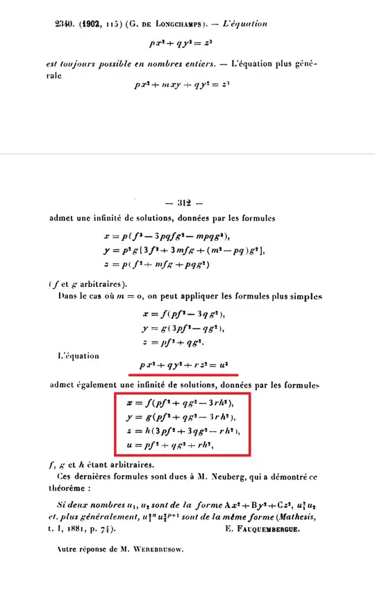

Refer to Gohierre de Longchamps's formula \begin{gather*} \left\{ \begin{split} a&=u\Big(\lambda\,\!u^2+\mu\,\!v^2-3\nu\,\!w^2\Big)\\ b&=v\Big(\lambda\,\!u^2+\mu\,\!v^2-3\nu\,\!w^2\Big)\\ c&=w\Big(3\lambda\,\!u^2+3\mu\,\!v^2-\nu\,\!w^2\Big)\\ d&=\lambda\,\!u^2+\mu\,\!v^2+\nu\,\!w^2 \end{split} \right.\\ \\ \Downarrow\\ \\ \Large{\lambda\,\!a^2+\mu\,\!b^2+\nu\,\!c^2=d^3} \end{gather*}
L'Intermédiaire des mathematiciens. 1902-1903. P311-312
