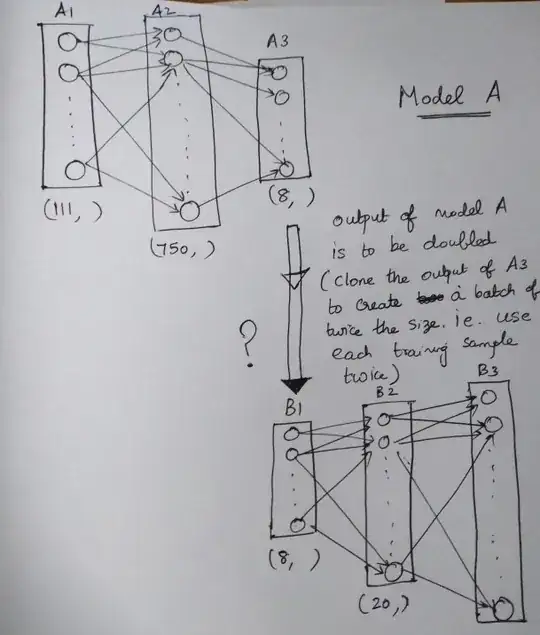

In this task, there are two neural networks - A & B, that are connected in a cascade formation, i.e. the output of model A feeds the input of model B. Please see the figure below.
graphical description of cascaded neural network

As I am quite new to the world of neural networks & Keras, I'd really appreciate any help from the community to implement the above steps in Keras. In particular, I am quite confused about implementing step 2 (please see the attached figure).
