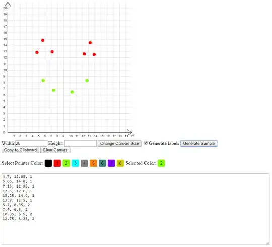

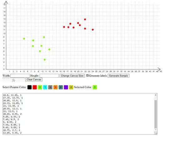

I recently discovered this site: https://guoguibing.github.io/librec/datagen.html
Outputs list of points, and color ID (class) for each point.
Screenshot: Datagen screenshot

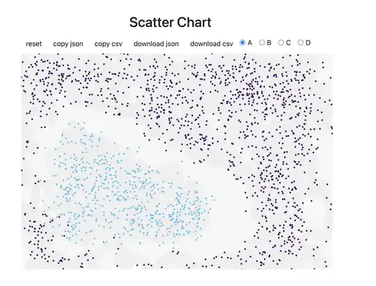

https://drawdata.xyz/
I think this one also good, the highest vote one, you have to click one by one to generate more data points, this one is much faster...
