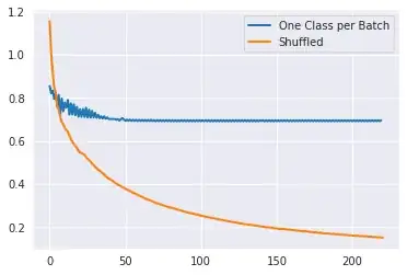

When we have well-shuffled batch -
In this case, the Gradient after each batch will be directed towards the overall Gradient because the Gradient will be averaged. It means a smooth Loss reduction with each batch
When we have each batch of one Class -
In this case, every alternate batch will move on two different Loss space(One of each Class).
The issue will be that we will calculate Loss for one space, but after the weight update at the end of a batch, the next batch will continue in its own space but using the weight from the previous batch. This will make learning very unpredictable.
Also, many logic applied in optimizers will not help because Gradient will randomly change with each batch.
I tried this on MNIST digit (just using 0,1 digit) and got this Loss per Batch. I have not out enough effort on LR optimization, LR decay, etc. So, can't conclude that result will be always similar.
$\hspace{3cm}$enter image description here
