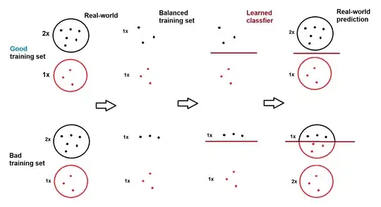

Will the model reproduce the trained target distribution from DS1 when applied on DS2?
No, not necessarily. If
  1. Balanced set DS1 is a good representative of imbalanced (target) set DS2, and
  2. Classes are well-separated (pointed out by @BenReiniger), which holds easier in higher dimensions,
then model will generate labels with a ratio close to imbalanced DS2 not balanced DS1. Here is a visual example (drawn by myself):
As you see, in the good training set, predictions resemble the real-world ratio, even though model is trained on a balanced set, of course, if classifier does a good job of finding the decision boundaries.
