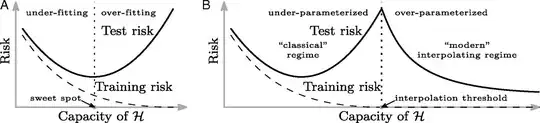

On what I imagine is a related note, I am familiar with the article "Reconciling modern machine-learning practice and the classical bias–variance trade-off" in PNAS, which has the thought-provoking image below. Is this something that's actually observed in practice -- that you can have minimal training error but good out-of-sample, generalizable performance, as shown in subpanel B?

I glanced over the paper, it seems very interesting. It would be truly fascinating to see if this phase transition from pattern recognition too interpolation of the data actually holds true as the authors claim, though I am a bit sceptical.
However, I think you are far away from interpolating your data. Your models are not very complex yet. So for your case we should be able to apply the classical principals of model selection.
If you look at the image you provided, figure A has an arrow that reads "sweet spot".
You see how before it the gap between the generalization error and the training error increases, but nonetheless the generalization error still decreases. You are around that spot.
Probably you are still before that spot. So I would recommend to still increase the complexity of your model and add layers.
