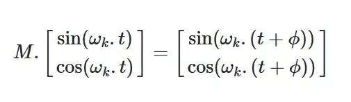

It is not clearly answered in the original paper, but if you go though this article(which I urge you to) the reason is that you can use a linear transformation to go from the two functions, to the same functions with an offset:
And if you wonder why having this property available is useful, if you dig into the comments below the article you will find the explanation you seek:
I suppose that this encoding framework enables the model to attend to relative positions by simply generating a transformation matrix, which only depends on the k. To be clear, I hypothesize that given any input PE(pos), the model can create the attention query matrix Q that targets PE(pos+k) by multiplying the PE(pos) with a weight matrix T (the transformation matrix). The weight matrix T, which could be parameters of a single feed-forward layer, can be learned during the training process.
Basically the model can learn a matrix not dependant on t as part o the trining to generalize all the range of encoding values.
Can we just use one of the other?
You could encode the values of the position, yes. But you would not have the property of having this linear transformation available, which seems to be a very important part for the learning process to succeed.
