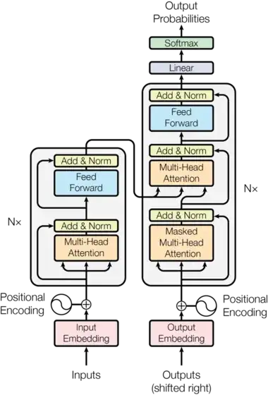

I'm trying to read and understand the paper Attention is all you need and in it, there is a picture:
I don't know what positional encoding is. by listening to some youtube videos I've found out that it is an embedding having both meaning and position of a word in it and has something to do with $sin(x)$ or $cos(x)$
but I couldn't understand what exactly it is and how exactly it is doing that. so I'm here for some help. thanks in advance.

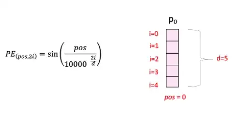

Here “pos” refers to the position of the “word” in the sequence. P0 refers to the position embedding of the first word; “d” means the size of the word/token embedding. In this example d=5. Finally, “i” refers to each of the 5 individual dimensions of the embedding (i.e. 0, 1,2,3,4)
While “d” is fixed, “pos” and “i” vary. Let us try understanding the later two.

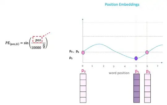

"pos"
If we plot a sin curve and vary “pos” (on the x-axis), you will land up with different position values on the y-axis. Therefore, words with different positions will have different position embeddings values.
There is a problem though. Since “sin” curve repeat in intervals, you can see in the figure above that P0 and P6 have the same position embedding values, despite being at two very different positions. This is where the ‘i’ part in the equation comes into play.

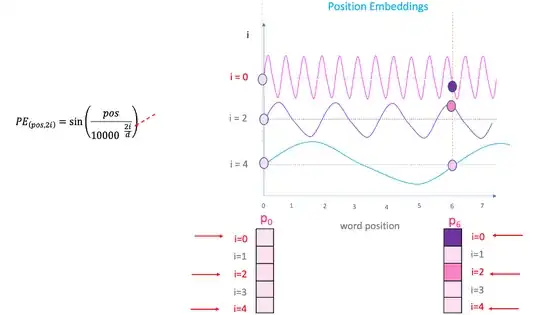

"i"
If you vary “i” in the equation above, you will get a bunch of curves with varying frequencies. Reading off the position embedding values against different frequencies, lands up giving different values at different embedding dimensions for P0 and P6.
Correction
Thanks to @starriet for the correction. "i" is not the index of the element "within" each vector, but the "sequence" of the vector. It is used for making alternate even and odd sequences (2i and 2i+1).
