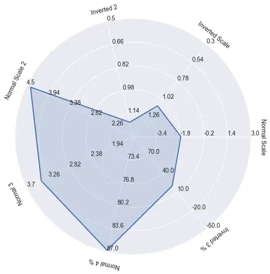

So, I want to create a Player Profile Radar Chart something like this:
Not only the scale of each variable different, but also I want a reversed scale for some statistics like the 'dispossessed' stat, where less actually means good.
One solution for the variable scale for each statistic maybe is setting a benchmark and then calculating a score on a scale of 100?
But, How do I display the actual numbers on the chart then? Also, how do I get the reversed scale for some of the statistics.
Currently working in Excel. What is the most powerful tool to create a complex chart like this?

Wow, this was bit challenging but I was able to make one of these plots in python. The two main components are:
code:
import numpy as np
import seaborn as sns # improves plot aesthetics
def _invert(x, limits):
    """inverts a value x on a scale from
    limits[0] to limits[1]"""
    return limits[1] - (x - limits[0])
def _scale_data(data, ranges):
    """scales data[1:] to ranges[0],
    inverts if the scale is reversed"""
    for d, (y1, y2) in zip(data[1:], ranges[1:]):
        assert (y1 <= d <= y2) or (y2 <= d <= y1)
    x1, x2 = ranges[0]
    d = data[0]
    if x1 > x2:
        d = _invert(d, (x1, x2))
        x1, x2 = x2, x1
    sdata = [d]
        if y1 > y2:
            d = _invert(d, (y1, y2))
            y1, y2 = y2, y1
        sdata.append((d-y1) / (y2-y1)
                     * (x2 - x1) + x1)
    return sdata
class ComplexRadar():
    def __init__(self, fig, variables, ranges,
                 n_ordinate_levels=6):
        angles = np.arange(0, 360, 360./len(variables))
        axes = [fig.add_axes([0.1,0.1,0.9,0.9],polar=True,
                label = "axes{}".format(i))
                for i in range(len(variables))]
        l, text = axes[0].set_thetagrids(angles,
                                         labels=variables)
        [txt.set_rotation(angle-90) for txt, angle
             in zip(text, angles)]
        for ax in axes[1:]:
            ax.patch.set_visible(False)
            ax.grid("off")
            ax.xaxis.set_visible(False)
        for i, ax in enumerate(axes):
            grid = np.linspace(*ranges[i],
                               num=n_ordinate_levels)
            gridlabel = ["{}".format(round(x,2))
                         for x in grid]
            if ranges[i][0] > ranges[i][1]:
                grid = grid[::-1] # hack to invert grid
                          # gridlabels aren't reversed
            gridlabel[0] = "" # clean up origin
            ax.set_rgrids(grid, labels=gridlabel,
                         angle=angles[i])
            #ax.spines["polar"].set_visible(False)
            ax.set_ylim(*ranges[i])
        # variables for plotting
        self.angle = np.deg2rad(np.r_[angles, angles[0]])
        self.ranges = ranges
        self.ax = axes[0]
    def plot(self, data, *args, **kw):
        sdata = _scale_data(data, self.ranges)
        self.ax.plot(self.angle, np.r_[sdata, sdata[0]], *args, **kw)
    def fill(self, data, *args, **kw):
        self.ax.fill(self.angle, np.r_[sdata, sdata[0]], *args, **kw)
# example data
variables = ("Normal Scale", "Inverted Scale", "Inverted 2",
            "Normal Scale 2", "Normal 3", "Normal 4 %", "Inverted 3 %")
data = (1.76, 1.1, 1.2,
        4.4, 3.4, 86.8, 20)
ranges = [(0.1, 2.3), (1.5, 0.3), (1.3, 0.5),
         (1.7, 4.5), (1.5, 3.7), (70, 87), (100, 10)]
# plotting
fig1 = plt.figure(figsize=(6, 6))
radar = ComplexRadar(fig1, variables, ranges)
radar.plot(data)
radar.fill(data, alpha=0.2)
plt.show()

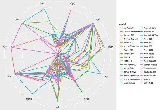

Here is an R version:
The codes here seem outdated for ggplot2: 2.0.0
Try my package zmisc: devtools:install_github("jerryzhujian9/ezmisc")
After you install it, you will be able to run:
df = mtcars
df$model = rownames(mtcars)
ez.radarmap(df, "model", stats="mean", lwd=1, angle=0, fontsize=0.6, facet=T, facetfontsize=1, color=id, linetype=NULL)
ez.radarmap(df, "model", stats="none", lwd=1, angle=0, fontsize=1.5, facet=F, facetfontsize=1, color=id, linetype=NULL)
The main codes were adapted from http://www.cmap.polytechnique.fr/~lepennec/R/Radar/RadarAndParallelPlots.html

Here is a small modification of Kyler Brown's solution for Python that also allows negative values on the polar axes (which are currently not officially supported by matplotlib), basically by simply removing the check for negative values from set_rgrids:
plot
import numpy as np
    # for d, (y1, y2) in zip(data[1:], ranges[1:]):
    for d, (y1, y2) in zip(data, ranges):
    x1, x2 = ranges[0]
    d = data[0]
    if x1 > x2:
        x1, x2 = x2, x1
    sdata = [d]
        if y1 > y2:
            y1, y2 = y2, y1
        sdata.append((d-y1) / (y2-y1) * (x2 - x1) + x1)
    return sdata
def set_rgrids(self, radii, labels=None, angle=None, fmt=None,
               **kwargs):
    Set the radial locations and labels of the *r* grids.
    The labels will appear at radial distances *radii* at the
    given *angle* in degrees.
    *labels*, if not None, is a ``len(radii)`` list of strings of the
    labels to use at each radius.
    If *labels* is None, the built-in formatter will be used.
    Return value is a list of tuples (*line*, *label*), where
    *line* is :class:`~matplotlib.lines.Line2D` instances and the
    *label* is :class:`~matplotlib.text.Text` instances.
    kwargs are optional text properties for the labels:
    %(Text)s
    ACCEPTS: sequence of floats
    # Make sure we take into account unitized data
    radii = self.convert_xunits(radii)
    radii = np.asarray(radii)
    rmin = radii.min()
    # if rmin <= 0:
    #     raise ValueError('radial grids must be strictly positive')
    self.set_yticks(radii)
    if labels is not None:
        self.set_yticklabels(labels)
    elif fmt is not None:
        self.yaxis.set_major_formatter(FormatStrFormatter(fmt))
    if angle is None:
        angle = self.get_rlabel_position()
    self.set_rlabel_position(angle)
    for t in self.yaxis.get_ticklabels():
        t.update(kwargs)
    return self.yaxis.get_gridlines(), self.yaxis.get_ticklabels()
                                         labels=variables)
        for ax in axes[1:]:
            ax.grid("off")
                         for x in grid]
            # ax.set_rgrids(grid, labels=gridlabel, angle=angles[i])
            set_rgrids(ax, grid, labels=gridlabel, angle=angles[i])
        self.ax = axes[0]
# example data
data = (-1.76, 1.1, 1.2,
        4.4, 3.4, 86.8, 20)
ranges = [(-5, 3), (1.5, 0.3), (1.3, 0.5),
         (1.7, 4.5), (1.5, 3.7), (70, 87), (100, -50)]
# plotting
radar.plot(data)
plt.show()
