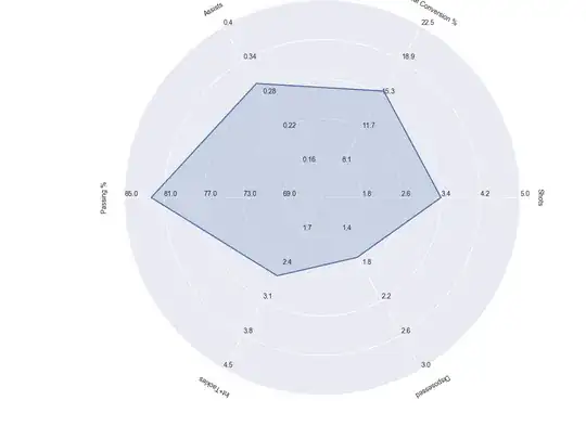

I'm trying to create radar plots for players's profiling. I got this solution from this previous question, but the graphic is not correctly centered and in fact there is a label that ends outside the plot.

def data2():
metrics = ('Shots', 'Goal Conversion %', 'Assists', 'Passing %', 'Int+Tackles', 'Disposessed')
firmino = (3.4, 15.7, 0.3, 82.3, 2.6, 1.7)
ranges = [(1, 5), (4.5, 22.5), (0.1, 0.4), (65, 85), (1, 4.5), (1, 3)]
fig = plt.figure(figsize=(12, 9))
radar = ComplexRadar(fig, metrics, ranges)
radar.plot(firmino)
radar.fill(firmino, alpha=0.2)
plt.savefig('firmino.png')
