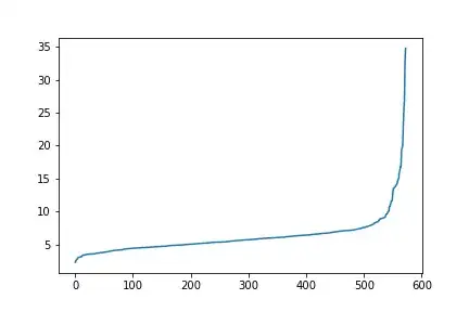

I am computing a distance metric on my data. The result is then being sorted in ascending order. The samples having distance more than a specific threshold are to be marked as outliers and will be discarded. Below is a plot of all distance values.
graph
As evident from the graph, after a certain point, the graph rises quite rapidly and even the datapoints get sparse. I need to calculate that point from where this happens and mark that point as threshold value.

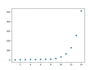

plt.scatter(data[:, 0], data[:, 1])
Plotting the data gives us the following figure:
figure 1

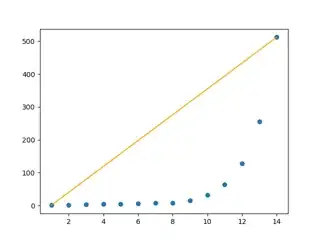

Now, let's try to find the elbow by combining the functions from above:
elbow_index = find_elbow(data, get_data_radiant(data))
print(elbow_index) # 10 print(data[elbow_index]) # array([11, 64])

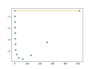

To sum it all up, we just calculated the slope from the min to the max value and then rotated the plot in such a way that the slope was zero. Subsequently, we took the min value of the data to get the elbow.
We can get the angle of rotation the following way:
angle = np.rad2deg(get_data_radiant(data))
print(angle)  # 88.543
The plot on the left has the slope included as an orange line. The scales of the axes make it look like it would have an angle of 45° while in reality, it has an angle of 88.5°! After vector rotation, the data looks like the plot on the right. From this data, we took the minimum value which was the 11th data point.
figure 2 figure 3
