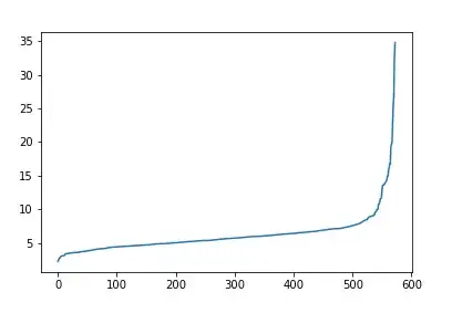

I want to rotate the below curve to 45 degree and then find the minimum point. enter image description here

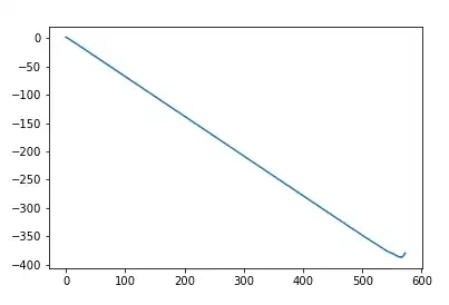

But what I get is this curve: enter image description here

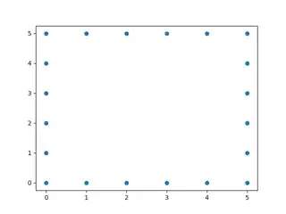

Now, we define a square as test-data:
data = np.array([
    [1, 0], [2, 0], [3, 0], [4, 0], [5, 0],
    [0, 0], [0, 1], [0, 2], [0, 3], [0, 4],
    [5, 1], [5, 2], [5, 3], [5, 4], [5, 5],
    [0, 5], [1, 5], [2, 5], [3, 5], [4, 5],
plt.scatter(data[:, 0], data[:, 1])
Plotting the data gives us the following figure:

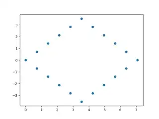

Now, we rotate that vector using the function from above:
rotated_data = rotate_vector(data, 45)
plt.scatter(rotated_data[:, 0], rotated_data[:, 1])
If we plot the rotated data, we get the following figure:
So it does work. However, if we want to rotate the graph that you posted to find the minimum, we need to remember that the scales of the two axes are different. That means the graph may look like a 45° rotation would be enough while actually, it is not.
I corrected the original post again. Also, I added a method to find an approximate rotation angle to account for the different axis scales.
