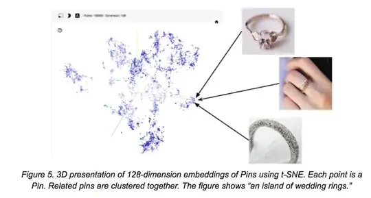

The best example might be Pinterest's application of the technique to group related Pins:
The folks at fastai have implemented categorical embeddings and created a very nice blog post with companion demo notebook.

A neural net is used to create the embeddings i.e. assign a vector to each categorical value. Once you have the vectors, you may use them in any model which accepts numerical values. Each component of vector becomes an input variable. For example, if you used 3-D vectors to embed your categorical list of colors, you might get something like: red=(0, 1.5, -2.3), blue=(1, 1, 0) etc. You would use three input variables in your random forest corresponding to the three components. For red things, c1=0, c2=1.5, and c3=-2.3. For blue things, c1=1, c2=1, and c3=0.
