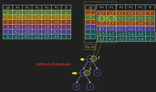

Knowing that the decision trees in the random forest are trained on different subsets of the training data (using random features ("feature bagging")), I used and developed the bootstrapped tables or sub-dataframe (resampled but with replacement) in the explanation for 1st DT for better understanding and find relationships in the video example: img Here I see 1st DT just both randomly selected variables from data:
x1 =< 4.9  #selected from `id=0` only
x0 =< 4.3  #selected from `id=0` only
So how they selected from id=0 only?

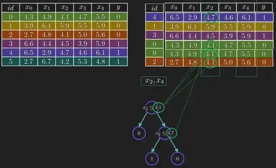

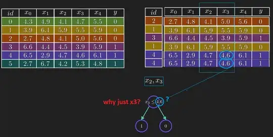

I follow other bootstrapped tables: img Then I see 2nd DT just both randomly selected variables from data:
x3 =< 4.6 #selected from `id=4` only
          # No x2 ??
So how they selected just from id=4 only? Is it a random id? I follow other bootstrapped tables: img Then I see 3rd DT, just both randomly selected variables from the data:

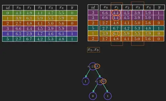

Finally, I see the fourth DT in the video, from both randomly selected variables from the data:
x1 =< 4.4 #selected from `id=3`
x2 =< 6.1 #selected from `id=1`
So Qs:
  • Based on which criteria split points are taken/selected for randomly selected pair variables?
  • Again, here twice, x1 was involved in the 4th tree without involving variable x1? Does it make sense?
  • I'm unsure what I marked based on my finding; explain the "criteria" of x > y, and if so, how it works. Sometimes both randomly selected pair variables are involved in DT; sometimes not.
  • I didn't get based on the pick split points y via id=#? Is there any rule, or is it just randomly picked? Can we say it is relative?
  • Final decision is being made when the end leaf is 0 or 1?

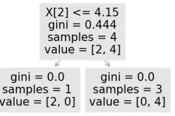

My pythonic implementation:
#Generate data in the video example
import pandas as pd
d = {'x0' : pd.Series([4.3, 3.9, 2.7, 6.6, 6.5, 2.7], index=[0, 1, 2, 3, 4, 5]),
     'x1' : pd.Series([4.9, 6.1, 4.8, 4.4, 2.9, 6.7], index=[0, 1, 2, 3, 4, 5]),
     'x2' : pd.Series([4.1, 5.9, 4.1, 4.5, 4.7, 4.2], index=[0, 1, 2, 3, 4, 5]),
     'x3' : pd.Series([4.7, 5.5, 5.0, 3.9, 4.6, 5.3], index=[0, 1, 2, 3, 4, 5]),
     'x4' : pd.Series([5.5, 5.9, 5.6, 5.9, 6.1, 4.8], index=[0, 1, 2, 3, 4, 5]),
     'y'  : pd.Series([0.0, 0.0, 0.0, 1.0, 1.0, 1.0], index=[0, 1, 2, 3, 4, 5]),
df = pd.DataFrame(d) print(df)
x0 x1 x2 x3 x4 y
#0 4.3 4.9 4.1 4.7 5.5 0.0 #1 3.9 6.1 5.9 5.5 5.9 0.0 #2 2.7 4.8 4.1 5.0 5.6 0.0 #3 6.6 4.4 4.5 3.9 5.9 1.0 #4 6.5 2.9 4.7 4.6 6.1 1.0 #5 2.7 6.7 4.2 5.3 4.8 1.0
#Create RF model
import numpy as np import pandas as pd import matplotlib.pyplot as plt plt.style.use('ggplot') %matplotlib inline import random from pprint import pprint import pdb from sklearn import tree from sklearn.tree import DecisionTreeClassifier from sklearn.ensemble import RandomForestClassifier
#Create and fit RF model with 4 trees rf = RandomForestClassifier(n_estimators=4, random_state=0) rf.fit(df.iloc[:,0:5], df.iloc[:,-1]) #len(rf.estimators_) #4
#Plot the trees for monitoring split points in 1/4 of trees (1st tree)
tree.plot_tree(rf.estimators_[0])
#Plot the trees for monitoring split points in 2/4 of trees (2nd tree)
tree.plot_tree(rf.estimators_[1])
#Plot the trees for monitoring split points in 3/4 of trees (3rd tree)
tree.plot_tree(rf.estimators_[2])
#Plot the trees for monitoring split points in 3/4 of trees (4th tree)
tree.plot_tree(rf.estimators_[3])
For every feature available for a node1, separation criteria are computed for multiple thresholds. They are multiple possible implementations for them:
  • use all data values as thresholds (which seem to be used in the video)
  • use the middle points of all successive data values (used by sklearn here)
So using your data and convention, if x1 is tested with all samples, the following thresholds are evaluated: [3.65, 4.6, 4.85, 5.5, 6.4]. When it is evaluated, separation criteria are computed as explained in this mathematical formulation. Then the threshold with the best separation criteria is selected.
See this very nice video about decision trees and how ther are built. (9:57 for continuous data + gini impurity computation)
1 So it doesn't compare multiple features. It is not relative. If you need such behaviour, you could add x-y as an input feature

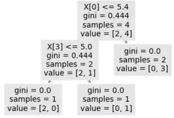

plot_tree interpretation (EDIT)
value=[2,4] in plot_tree means that you have currently 6 samples1. 2 from class 0 and 4 from class 1. In your rf.estimators_[3], this dataset has been splitted with feature 0 because it has been evaluated as the best split (minimum impurity with gini=0.444). 3 samples from class 1 went to the right leaf, and the others went to the left node before being splitted again by feature 3.
I think, if I understand correctly, that you're confusing the build from the video and the one from . They are different because of the random subsampling, both on samples and features. To generate new samples to be used for DecisionTreeClassifier, see this sklearn _generate_sample_indices() function. In the video, samples id are not the same.
So, x1 is used in the 4th tree of the video, but not in the 4th tree in your code.

At each node, a lot of thresholds are evaluated and criteria computed. For example, in the video, for the 1st tree in the 1st node, the following subdataset is used:
subdataset
For x0, they are 3 different values, so 3 thresholds are evaluated. For x1, 4. That makes 7 entropy (or gini) criteria values. The best is then selected.

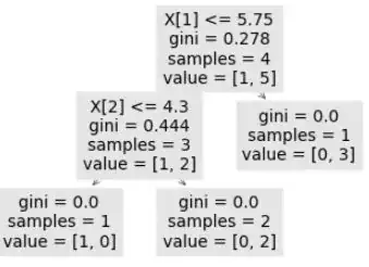

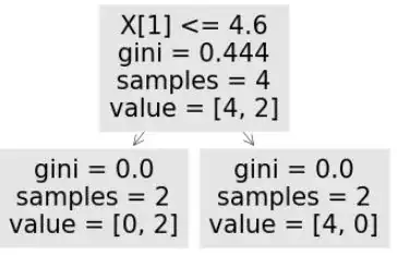

SAMPLE CODE
Here is a sample code that you can execute with your code, and that shows the 4 DecisionTreeClassifier()s build from the subdatasets. Note that I did not find an explicit function to extract the sub-feature indexes. Note that if you plot the trees, they are all similar to the ones built from RandomForestClassifier() except for the 3rd, but its first node has the same best gini separation. So the difference comes from a different order somewhere; I did not figure out where...
from sklearn.ensemble._forest import _generate_sample_indices
sub_features_indexes = [
    [0, 1], # pair features (x0 , x1) based on video tutorial
    [2, 3], # pair features (x2 , x3) based on video tutorial
    [2, 4], # pair features (x2 , x4) based on video tutorial
    [1, 3]  # pair features (x1 , x3) based on video tutorial
for i in range(4): seed = rf.estimators_[i].random_state boostraped_samples = df.loc[_generate_sample_indices(seed, 6, 6)].sort_index()
#sliced frame based on video tutorial
boostraped_samples_dfslice = boostraped_samples[boostraped_samples.columns[[sub_features_indexes[i][0],sub_features_indexes[i][1], -1 ]]]
display(boostraped_samples_dfslice)
dtc = DecisionTreeClassifier(random_state=seed)
dtc.fit(boostraped_samples.iloc[:,sub_features_indexes[i]], boostraped_samples.iloc[:,-1])
tree.plot_tree(dtc)
plt.show()
When evaluating the value of id=4, so 4.6, as a threshold, the labels are perfectly separated, so there is no need to go further. But, that doesn't mean x2 was not evaluated. It was, but it doesn't separate the labels better than choosing 4.6 as the threshold on feature x3
