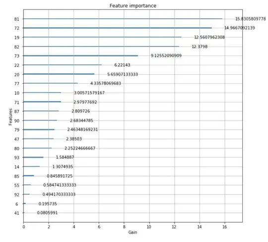

I need to quantify the importance of the features in my model. However, when I use XGBoost to do this, I get completely different results depending on whether I use the variable importance plot or the feature importances.
For example, if I use model.feature_importances_ versus xgb.plot_importance(model) I get values that do not align. Presumably the feature importance plot uses the feature importances, bu the numpy array feature_importances do not directly correspond to the indexes that are returned from the plot_importance function.
Here is what the plot looks like:
But this is the output of model.feature_importances_ gives entirely different values:

If I just try to grab Feature 81 (model.feature_importances_[81]), I get:0.051136363. However model.feature_importances_.argmax() returns 72.
So the values do not correspond to each other and I am unsure about what to make of this.
Does anyone know why these values are not concordant?

In xgboost 0.7.post3:
  1. XGBRegressor.feature_importances_ returns weights that sum up to one.
  2. XGBRegressor.get_booster().get_score(importance_type='weight') returns occurrences of the features in splits. If you divide these occurrences by their sum, you'll get Item 1. Except here, features with 0 importance will be excluded.
  3. xgboost.plot_importance(XGBRegressor.get_booster()) plots the values of Item 2: the number of occurrences in splits.
  4. XGBRegressor.get_booster().get_fscore() is the same as XGBRegressor.get_booster().get_score(importance_type='weight')
Method get_score returns other importance scores as well. Check the argument importance_type.
In xgboost 0.81, XGBRegressor.feature_importances_ now returns gains by default, i.e., the equivalent of get_score(importance_type='gain'). See importance_type in XGBRegressor.
So, for importance scores, better stick to the function get_score with an explicit importance_type parameter.
Also, check this question for the interpretation of the importance_type parameter: "weight", "gain", and "cover".
