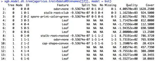

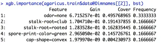

Thanks Sandeep for your detailed answer. I would like to correct that cover is calculated across all splits and not only the leaf nodes.
Let's go through a simple example with the data provided by the xgboost library.
library('xgboost')
data(agaricus.train, package='xgboost')
data(agaricus.test, package='xgboost')
train <- agaricus.train
test <- agaricus.test
X = train$data
y = train$label
bst <- xgboost(data = X, label = y, max.depth = 2,
           eta = 1, nthread = 2, nround = 2,objective = "binary:logistic",
           reg_lambda = 0, reg_alpha = 0)
xgb.model.dt.tree(agaricus.train$data@Dimnames[[2]], model = bst)
xgb.importance(agaricus.train$data@Dimnames[[2]], bst)
Output -
Tree dump
Importance matrix
Let's try to calculate the cover of odor=none in the importance matrix (0.495768965) from the tree dump.
Cover of each split where odor=none is used is 1628.2500 at Node ID 0-0 and 765.9390 at Node ID 1-1.
Total cover of all splits (summing across cover column in the tree dump) = 1628.2500*2 + 786.3720*2
Cover of odor=none in the importance matrix = (1628.2500+765.9390)/(1628.2500*2+786.3720*2)
Hence we are sure that cover is calculated across all splits!
