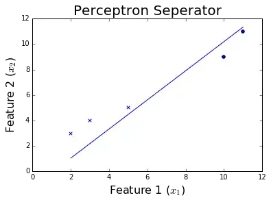

This is just a straight line which splits data into two sections. Let us apply this model in 2D, where we have two features $x = [x_1, x_2]$, for example weight and height. And labels $y$ which will split our data into $y \in \{men, women\}$.
A random line in this space is defined as
$0 = -2x_2 + x_1 + 1$.
Assume this is our boundary line. Let's just assume that women fall above this line and men fall below it. Like this
Now if we get a new data point $x_{new} = [2, 8]$ we will label this as being a woman. So the entire decision is based on the numbers $1, -2, 1$ from our linear equation. We need to tune these values using the training data. We usually call these trainable parameters the weights $w$ associated with the features $x$ and we also add a bias $b$. In general the linear separator in 2D is

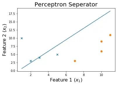

How do the weights affect the decision boundary. We want the two different classes, circles and x's, to be on opposite sides of this boundary in order for us to be able to correctly classify them.

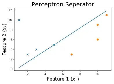

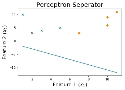

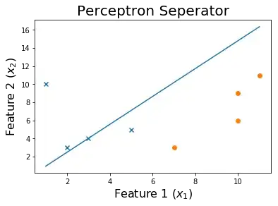

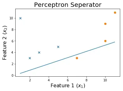

The weights are trained iteratively using gradient descent. We can see that the decision boundary starts off terribly and then gets progressively better.
$0 = -1.0 - 1.0x_1 - 1.0x_2$
$0 = -16.0 - -39.0x_1 - 71.0x_2$
$0 = -36.0 - -94.0x_1 - 61.0x_2$
$0 = -83.5 - -134.0x_1 - 76.0x_2$
$0 = -88.5 - -114.0x_1 - 98.5x_2$
As you can see we changed the weights until we were able to find this ideal boundary between the two classes. If you want to find our more about how the gradient descent algorithm works to tune these weights you can look here.
