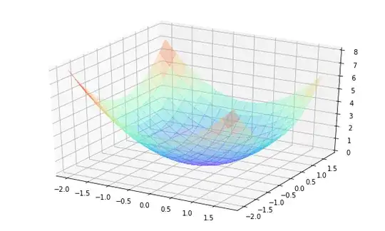

Note The Code Is Self Explanatory(It's Hard-coded)..
Here's the function which we are considering
def f(a,b):
    return a**2 + b**2
fig = plt.figure(figsize=(10, 6))
ax = fig.gca(projection='3d')
plt.hold(True)
a = np.arange(-2, 2, 0.25)
b = np.arange(-2, 2, 0.25)
a, b = np.meshgrid(a, b)
c = f(a,b)
surf = ax.plot_surface(a, b, c, rstride=1, cstride=1, alpha=0.3,
                       linewidth=0, antialiased=False,cmap='rainbow')
ax.set_zlim(-0.01, 8.01)

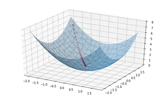

Here's a 3D view of Gradient Descent Reaching The Optimum(in case interested, it will not always work, Have a look at the end plot..)
def gradient_descent(theta0, iters, alpha):
    history = [theta0] # to store all thetas
    theta = theta0     # initial values for thetas
    # main loop by iterations:
    for i in range(iters):
        # gradient is [2x, 2y]:
        gradient = [2.0*x for x in theta]
        # update parameters:
        theta = [a - alpha*b for a,b in zip(theta, gradient)]
        history.append(theta)
    return history
history = gradient_descent(theta0 = [-1.8, 1.6], iters = 30, alpha = 0.03)
plt.hold(True)
c = f(a,b)
                       linewidth=0, antialiased=False)
a = np.array([x[0] for x in history])
b = np.array([x[1] for x in history])
c = f(a,b)
ax.scatter(a, b, c, color="r");
plt.show()
And Here's the output we will get

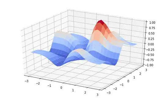

When Gradient Descent will fail (unfortunately)..
  • Unfortunately, if the function has many extrema, then the Gradient Descent could find the local minimum instead of global minimum. One trick is to overcome this disadvantage is to run SGD several times with different initial guessed values for $x$. enter image description here
