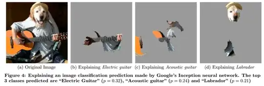

  • Neural Networks can be understood. There are many analyzation techniques (see chapter 2.5 of my master thesis for some which are aimed at improving the model). Especially occlusion analysis (Figure 2.10), Filter visualization (Figure 2.11). Also the Why Should I Trust You? paper (my notes).
Explaining the prediction of a black-box model by fancy occlusion analysis (from "Why should I trust you?"): enter image description here
