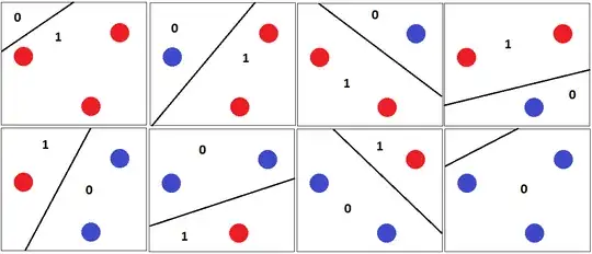

It is easy to find a set of three points that can be classified correctly no matter how they are labeled:
For all $2^3=8$ possible labelings we can find a hyperplane that separates them perfectly.

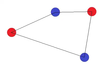

Assume for now, that the 4 points form a figure with 4 sides. Then it is impossible to find a hyperplane that can separate the points correctly if we label the opposite corners with the same label:

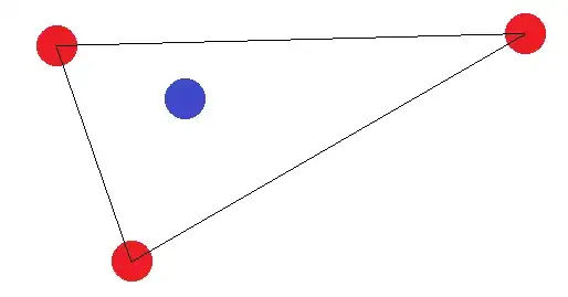

If they don't form a figure with 4 sides, there are two "boundary cases": The "outer" points must either form a triangle or all form a straight line. In the case of the triangle, it is easy to see that the labeling where the "inner" point (or the point between two corners) is labeled different from the others can't be achieved:

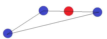

In the case of a line segment, the same idea applies. If the end points are labeled differently than one of the other points, they cannot be separated by a hyperplane.
