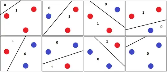

I'm studying machine learning from Andrew Ng Stanford lectures and just came across the theory of VC dimensions. According to the lectures and what I understood, the definition of VC dimension can be given as,
If you can find a set of $n$ points, so that it can be shattered by the classifier (i.e. classify all possible $2^n$ labeling correctly) and you cannot find any set of $n+1$ points that can be shattered (i.e. for any set of $n+1$ points there is at least one labeling order so that the classifier can not separate all points correctly), then the VC dimension is $n$.
Also Professor took an example and explained this nicely. Which is:
Let,
$H=\{{set\ of\ linear\ classifiers\ in\ 2\ Dimensions \}}$
Then any 3 points can be classified by $H$ correctly with separating hyper plane as shown in the following figure.
And that's why the VC dimension of $H$ is 3. Because for any 4 points in 2D plane, a linear classifier can not shatter all the combinations of the points. For example,

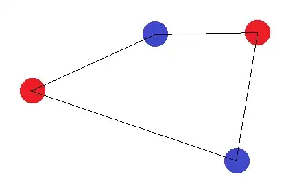

For this set of points, there is no separating hyper plane can be drawn to classify this set. So the VC dimension is 3.

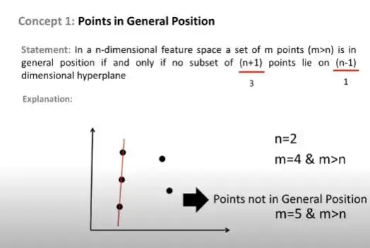

The points should fulfil points in general condition before consider for VC dimension. enter image description here

So based on the definition we need to find $2^n$ arrangements that can be shattered by a linear boundary, which you have shown in the figure. Therefore, it does not matter if there are other arrangements that cannot be shattered.
For $n = 4$ we cannot find $2^n = 16$ arrangements that can be shattered by a linear boundary hence we say we cannot shatter $4$ points with a linear boundary in a 2D plane.
