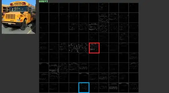

They try to reduce the cost by learning low level, sometimes meaningless, features like horizontal and vertical lines in their first layers and then stacking them to make abstract shapes, which often have meaning, in their last layers. For illustrating this fig. 1, which has been used from here, can be considered. The input is the bus and the gird shows the activations after passing the input through different filters in the first layer. As it can be seen the red frame which is the activation of a filter, which its parameters have been learned, has been activated for relatively horizontal edges. The blue frame has been activated for relatively vertical edges. It is possible that ConvNets learn unknown filters that are useful and we, as e.g. computer vision practitioners, have not discovered that they may be useful. The best part of these nets is that they try to find appropriate filters by their own and don't use our limited discovered filters. They learn filters to reduce the amount of cost function. As mentioned these filters are not necessarily known.
**Figure 1.** *Low level activations*

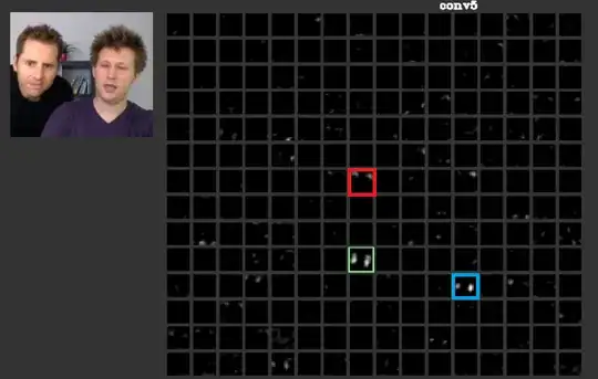

In deeper layers, the features learned in previous layers come together and make shapes which often have meaning. In this paper it has been discussed that these layers may have activations which are meaningful to us or the concepts which have meaning to us, as human beings, may be distributed among other activations. In fig. 2 the green frame shows the activatins of a filter in the fifth layer of a ConvNet. This filter cares about the faces. Suppose that the red one cares about hair. These have meaning. As it can be seen there are other activations that have been activated right in the position of typical faces in the input, the green frame is one of them; The blue frame is another example of these. Accordingly, abstraction of shapes can be learned by a filter or numerous filters. In other words, each concept, like face and its components, can be distributed among the filters. In cases where the concepts are distributed among different layers, if someone look at each of them, they may be sophisticated. The information is distributed among them and for understanding that information all of those filters and their activations have to be considered although they may seem so much complicated.
**Figure 2.** *High level activations*
