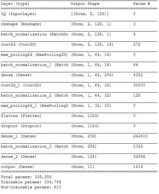

Neural Network is a Convolutional Neural Network coded as below:
DROPOUT_RATE = 0.5
iq_in = keras.Input(shape=in_shp, name="IQ") reshape = Reshape(in_shp + [1])(iq_in) batch_normalization = BatchNormalization()(reshape)
conv_1 = Convolution2D(16, 4, padding="same", activation="relu")(batch_normalization) max_pool = MaxPooling2D(padding='same')(conv_1) batch_normalization_2 = BatchNormalization()(max_pool) fc1 = Dense(256, activation="relu")(batch_normalization_2) conv_2 = Convolution2D(32, 2, padding="same", activation="relu")(fc1) batch_normalization_3 = BatchNormalization()(conv_2) max_pool_2 = MaxPooling2D(padding='same')(batch_normalization_3)
out_flatten = Flatten()(max_pool_2) dr = Dropout(DROPOUT_RATE)(out_flatten) fc2 = Dense(256, activation="relu")(dr) batch_normalization_4 = BatchNormalization()(fc2) fc3 = Dense(128, activation="relu")(batch_normalization_4) output = Dense(11, name="output", activation="softmax")(fc3)
model = keras.Model(inputs=[iq_in], outputs=[output]) model.compile(loss='categorical_crossentropy', optimizer='adam')
model.summary()

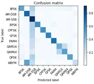

Results
ConfusionMatrix

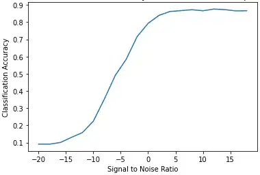

My evaluation system evaluate how accurate is my Neural Network for classifying signals with different SNR.
Accuracy_2_SNR

There is relatively little data for a deep learning solution - 220 total data points and 20 data points for each of the 11 labels.
Increasing the amount of data would probably have the greatest impact on model performance. The best option would be to collect more data. Another option would be data augmentation.
