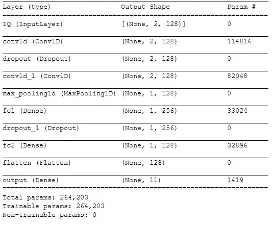

Neural Network is a Convolutional composed sequentially by 2 convolutional layers, and 3 fully connected.
DROPOUT_RATE = 0.5
iq_in = keras.Input(shape=in_shp, name="IQ")
conv_1 = Convolution1D(128, 7, input_shape=(1, 2, 128), padding="same", activation="relu")(iq_in) dr_1 = Dropout(DROPOUT_RATE)(conv_1) conv_2 = Convolution1D(128, 5, padding="same", activation="relu")(dr_1) max_pool = MaxPooling1D(padding='same')(conv_2)
fc1 = Dense(256, name="fc1")(max_pool) dr_2 = Dropout(DROPOUT_RATE)(fc1) fc2 = Dense(128, name="fc2")(dr_2) out_flatten = Flatten()(fc2) output = Dense(11, name="output")(out_flatten)
model = keras.Model(inputs=[iq_in], outputs=[output]) model.compile(loss='categorical_crossentropy', optimizer='adam')
model.summary()
neuralnetwork

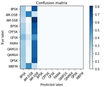

Results
This is the confusion matrix outputted by my evaluation system.
confusionmatrix
Question
How to improve performance? Can someone criticize my Neural Network?

There are a couple of things I would suggest:
  1. Reshape the input data: It looks to me that you want to analyse a time series if IQ-values and each time series is 128 datapoints. In this case you probably want to treat I and Q as the channels respectively and convolve over ther 128 points. To do this the input data needs to be of shape (128, 2). Right now you treat your data points as 128-dimensional vectors and convolve over the two channels I and Q.
  2. Flatten between convolutional and dense part: Usually you have the Convolution1D and MaxPooling1D layers extract some spatial features. The fully connected layers have no notion of spatial properties, they just "understand" vectors. So most models have the Flatten layer just before the Dense layers.
  3. Activation functions of the dense layers: Unless an activation is specified in the Dense layers, they use a linear activation, which does not really harvest the expressive power of the layer (see here). So fc1 and fc2 should probably get an activation="relu" as well.
  4. Output activation: I would also use a softmax activation for the output, otherwise you can not interpret the output as probabilities for class membership.
