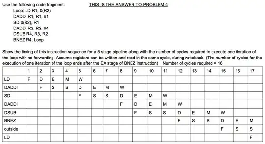

One of the problems is as follows (apologies for the image, as I was unable to format this using $\LaTeX$):

Here F,D,E,M and W refer to the five stages in a pipeline i.e Instruction Fetch, Instruction Decode, Execution/Effective Address Cycle, Memory Access and Write-Back Cycle.
Is the give solution correct?
My attempt was:
Here, in the second instruction i.e DADDI , there are only two stalls. But since there is no operand forwarding, I believe the contents of the register be available after they've been written into the register file and so, there should be three stalls.
From what I could understand in this solution, the value from the register file is available after the M stage, before it is written. Is that possible?

You would be correct, however the question specifically states:
Assume registers can be written and read in the same cycle, during writeback
This means that in cycle 5, 'W' and 'D' are allowed to occur simultaneously, and there must be some sort of implicit forwarding between the two. In light of these assumptions, 2 stalls is right, not 3.
