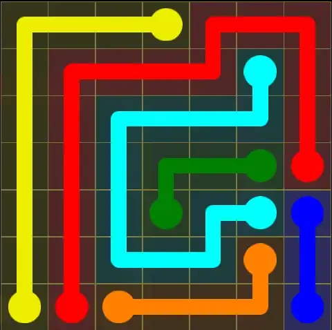

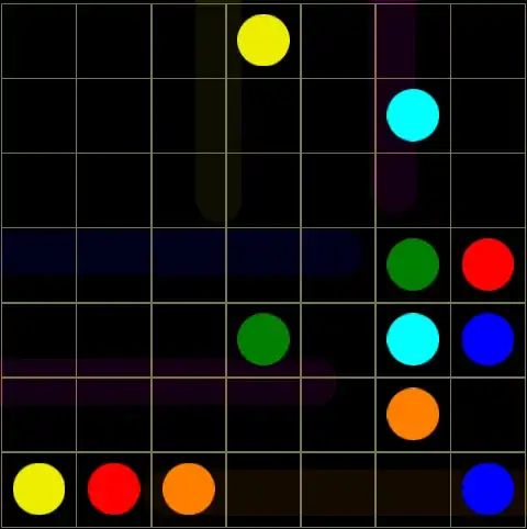

In this game, you start with several pairs of squares on a grid, and you have to connect each pair, without crossing the paths, and by using every square on the grid. Here's a simple 7x7 example (the hardest boards in the game are 11x13).
Beginning:
Beginning layout
Finished:
Finished board
