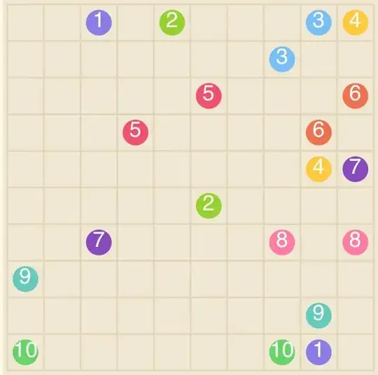

- Here is a matrix, probably with some cells blocked(couldn't pass through)
- There are several pairs of numbered points
- connect each pairs of points with right angle lines, the lines shouldn't intersect
- lines and points should cover all available places
So, how to find out the solution if the solution exists? Here is an example image.
