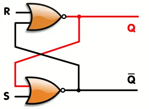

One thing I did find was this great diagram of a flip flop, which certainly demonstrates the need to consider timing in hardware design. Rather than dealing with explicit on/off states, you are also dealing with high/low voltage propagation.

HDL are used for two purposes: synthesis and simulation. For the first purpose, there is no more use of time than for a programming language. For the second purpose, time is inherently part of what is to be simulated. You need to know after which delay $Q$ will change after a change of $R$, and after which delay $\bar Q$ will do the same. The time here is thus not the real time, but a simulated one, which has no easy relationship with the real time during which the simulation will occurs.
Your circuit will be described in a VHDL-like syntax:
Q <= not (R or QBar) delay 1ns;
QBar <= not (S or Q) delay 1ns;
You can also write an oscillator, with no stable state:
Clock <= not Clock delay 5ns;
Time is thus present in the syntax of the language, and in its semantic as well (the language clearly states that $\bar Q$ will change 2ns of simulated time after $R$ does).

All the discussion above has used a logical notion of time. It's easy to go from there to a notion of real time by simply specifying a rate for the top-level fastest clock(s). However, the logical time model treats calculations as happening instantaneously. The execution time can be modeled by inserting delays into operations and/or using clocks running at different rates. However, while VHDL and Verilog do use a programming model similar to what I've described above, and they do provide annotations to specify timing, the latter are more descriptive than prescriptive. A functional simulation doesn't need them and the synthesizer ignores them (i.e. it assumes they accurately describe the chosen hardware). The annotations get used for timing simulations. In a functional simulation, the delays that need to exist for situations like your flip-flop to have a well-defined behavior are called delta delays and are conceptualized as "infinitesimal" time delays. In the SDF model, these delays would happen automatically. In a synchronous reactive model delays would need to be inserted (though will typically be embedded in primitives) and the delta delays correspond to ticks of the global logical clock. The notion of superdense time described in the Ptolemy II book in section 1.7.2 may also be a useful tool here.
