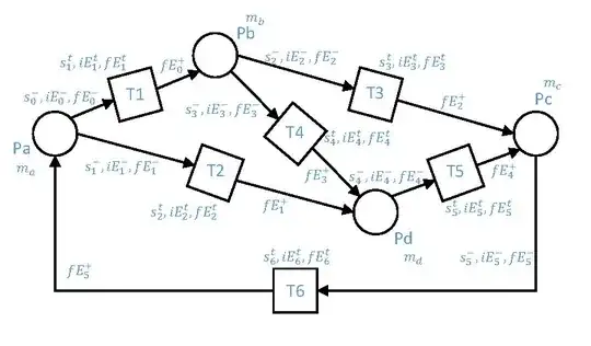

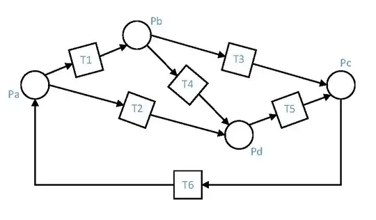

Firs reason. The process logic can be created one element at a time. This means that a net can be extended by adding elements to the existing net (Petri, 1966). For example, a model of a controller can be divided into internal and external components. The internal component regulates the system. The external component interfaces with the environment by accepting input from the environment. Figure 1 is a Petri Net model of the internal component. It is possible to add a Petri Net model of the external component to the Petri Net model of the internal component by adding the appropriate places and transition (Figure 2).
Figure 1 A Petri Net Model of an Internal Component of a Controller (Halloway, Krogh and Giua, 1997) A Petri Net Model of an Internal Component of a Controller (Halloway, Krogh and Giua, 1997)
Figure 2 A Petri Net Model of an Internal and External Components of a Controller (Halloway, Krogh and Giua, 1997) A Petri Net Model of an Internal and External Components of a Controller (Halloway, Krogh and Giua, 1997)

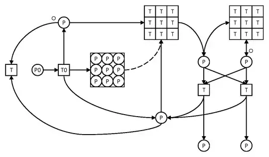

Figure 3 A Petri Net model of a card game A Petri Net model of a card game
I have at least three reason why I find the application of Petri Nets challenging (disadvantages?)
If there are too many graphics objects then it would be difficult to create or to read the net. The difficulty may be mitigated by taking a subset of the graphics and represent them using one, two or three graphics symbol (Noe, 1973; Petri, 1966). For example, if the Petri Net model of a card game in Figure 3 is considered to have too many graphic objects in the diagram, it is possible to combine some of the graphics and still maintain enough information to map the diagram into a computer program. Consider Figure 4, a Petri Net model of the same game found in Figure 3 with high-level graphics (Chionglo, 2016a).
Figure 4 A Petri Net Model of a Card Game using High-Level Graphics (Chionglo, 2016a) A Petri Net Model of a Card Game using High-Level Graphics (Chionglo, 2016a)

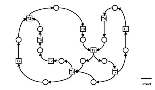

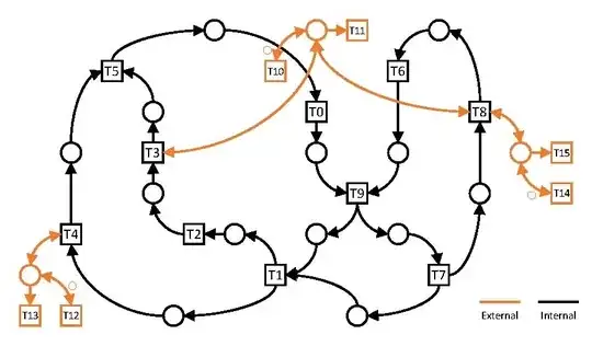

In another example, the external components of the controller in Figure 2 can be combined to create a more concise graphic representation as shown in Figure 5.
Figure 5 A Petri Net Model of a Controller with High-Level Graphics for External Components A Petri Net Model of a Controller with High-Level Graphics for External Components

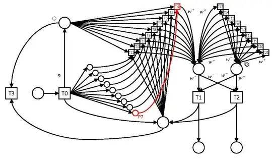

Finally, a mutually exclusive set of places or a mutually exclusive set of transitions may also be represented using a high-level graphics object (Chionglo, 2015).
Second reason. Even with standard graphics, it can be challenging to draw and position graphics especially if one expects the final diagram to be user- or reader-friendly. Some of the decisions for making a user- or reader-friendly diagram include: the proper layout of graphics objects, the appropriate dimensions of the canvas and shapes, the curvature of arrows, the type of arrow heads, the size and font of text, and the choice of colours for graphics and text.
