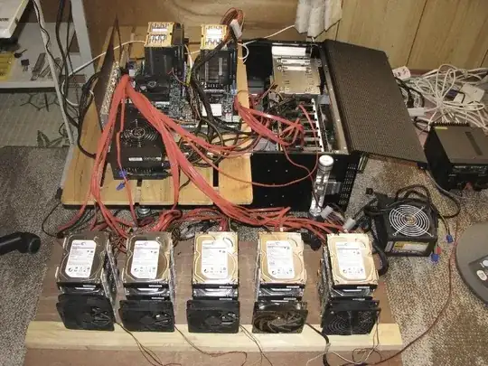

12 trillion digits of $ \pi $ required the following not simple kit and about a week to compute using a BPP variant:-
large pc
