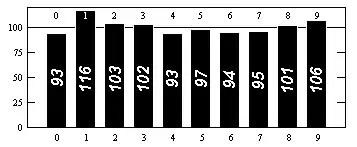

If you ask whether you can get a normal sequence out of $\pi$ (i.e., all numbers appear uniformly), then there are several answers on mathoverflow. For example, the answer about Distribution of the digits of Pi says:
...it is believed that $\pi$ is a normal number (~uniform distribution of every digits sequence).
For digit distribution data, see e.g. http://www.eveandersson.com/pi/precalculated-frequencies or https://thestarman.pcministry.com/math/pi/RandPI.html (first 1000 digits):
