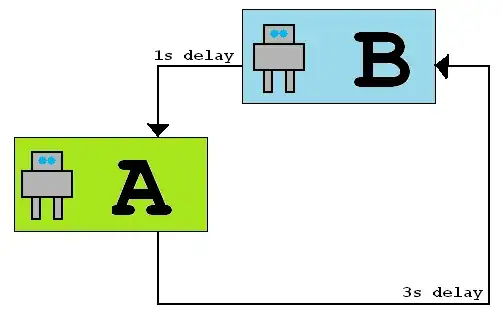

Suppose two robots are in two rooms, connected by a network with differing one-way latencies as shown in the graphic below. When robot A sends a message to robot B it takes 3 seconds for it to arrive, but when robot B sends a message to robot A it takes 1 second to arrive. The latencies never vary.
The robots are identical and do not have a shared clock, though they can measure the passage of time (e.g. they have stop watches). They do not know which of them is robot A (whose messages are delayed 3s) and which is robot B (whose messages are delayed by 1s).

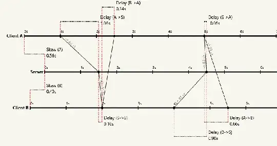

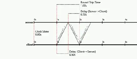

The following diagram, from a blog post I wrote, is a visual proof that it's impossible:
Sliding the clock skew exactly offset by latency asymmetry
Notice how the packet arrival times on each side stay the same, even as the one-way latencies change (and even become negative!). The first packet always reaches the server at 1.5s on the server's clock, the second always reaches the client at 2s on the client's clock, etc. The packet contents and local arrival times are the only things a protocol could be based on, but the contents and arrival times can be held constant as the asymmetry varies by also varying the initial clock skew.
Basically, asymmetry in the one-way latencies looks exactly like clock skew. Since the problem states we don't start off knowing the initial clock skew or the one-way latency asymmetry, and varying one looks like varying the other so their effects are indistinguishable, we can't separate their contributions in order to solve for the one-way latency asymmetry. It's impossible.
More formally, you can't solve for edge lengths when given only the lengths of the cycles. The cycle basis has $n-1$ degrees of freedom, corresponding to $n-1$ unknown clock skews relative to one of the participants. You can always hide the one-way latencies, even when there are many participants:

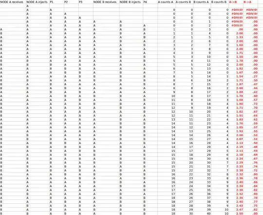

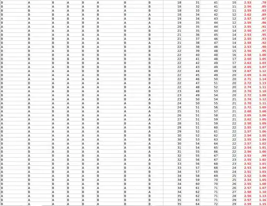

SIMULATION RESULT TRACE Here is a simulation that proves the above and shows how A successfully converging toward 3 second delay and B converging around 1 second delay:
First seconds of Simulation
Subsequent seconds of Simulation
Explanation of Figures: Each line represents 1 second of time (packet size is chosen to have 1 second transmission time for clarity). Note that each node can start the algo at any time not in any particular sequence or time. The columns are as follows:
  • NODE A receives : What node A sees in its receiving side (this is also P4 below)
  • NODE A injects : What node A sends out (note this is A, or randomly A or B)
  • P1, P2, P3 : The three packets that are in transit (in order) between A and B (1 second transmission means 3 packets are in transit for a latency of 3)
  • NODE B receives : What B sees in its receiving side (this is P3)
  • NODE B injects : What B sends out (note this is B, or randomly A or B per algo)
  • P4 : The packet in transit from B to A (see also P1, P2, P3)
  • A counts A : What A counts for the A packets it has seen
  • A counts B : What A counts for the B packets it has seen
  • B counts A : What B counts for the A packets it has seen
  • B counts B : What B counts for the B packets it has seen
  • A->B : The latency that A estimates towards B (ratio of RTT of 4 seconds based on packets seen)
  • B->A : The latency that B estimates towards A (ratio of RTT of 4 seconds based on packets seen)
As we can see both nodes converge and stay around their true latency (actually we do not see that for A because more seconds are needed to converge but it does converge same behavior as B)
Better filters could converge faster but we can clearly see how they both converge around the correct values for their delays, therefore they can exactly know know their delay (even though I am showing their estimation only for illustration).
