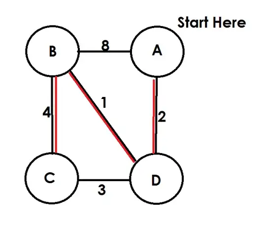

Edit for clarity:
The Nearest Neighbor Algorithm is described here. From what I read, it works like so:
startVertex = vertex V
for (egdes : totalEdges){
    find the edge with the smallest weight connected to vertex V that has    not been visited
nextVertex = vertex on the other end of the edge with the smallest weight
move to nextVertex
Here is an example:
Each vertex is visited and, looking at the red lines, you get an MST for that graph.
If you do that, you get an MST. My question is, is that a valid way of getting an MST? It seems like it is since it's so much like Kruskal's or Prim's algorithm.

Your algorithm starts at some vertex and then always move to the closest vertex that's not been visited so far. That's not guaranteed to find the minimum spanning tree, as the example in your question shows.
First, in a general graph, the algorithm might get stuck: you might end up at a vertex where you've already visited all the neighbours. For example, if you start your algorithm at $D$, it will go to $B$, then $C$ and then it's stuck because it's already visited both of $D$'s neighbours. The set-up of Hamiltonian cycle avoids this possibility by having an edge between every pair of vertices.
Second, even if your graph contains every possible edge, the algorithm can only produce a path, so it won't produce the minimum spanning tree in any graph where the M.S.T. isn't a path. For example, take vertices $\{1, \dots, n\}$ with $w(1,i)=1$ for all $i$ and $w(i,j)=2$ for all $i,j\geq 2$. The M.S.T. is all the edges from $1$, and this has weight $n-1$. But your algorithm will find some path that uses only one or two of the weight-$1$ edges, so will have weight $2n-3$ or $2n-4$.

Your algorithm (if I understand it correctly) is known as Prim's algorithm, another algorithm that finds a minimum spanning tree.
